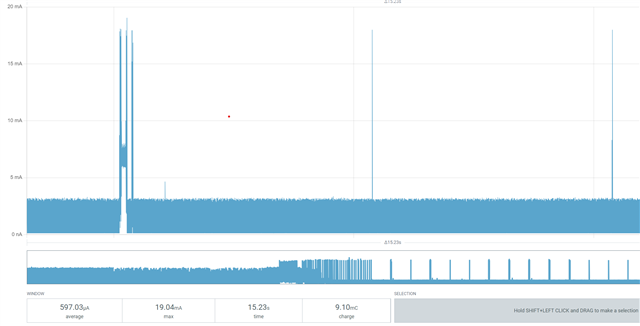

High current consumption in the Template Matter sample
I have followed the guide Adding clusters to Matter application to add two TemperatureMeasurement clusters to the Template sample.
I have flashed this onto an nRF52840-DK and hooked up a PPKII to the External Supply. I have switched SW6 to nRF ONLY to take the peripherals out of the equation.
The power consumption is a whopping 500µA even with CONFIG_SERIAL=n
In this post, Power consumption of Matter template example - Nordic Q&A - Nordic DevZone - Nordic DevZone, the user converts to from a Minimal Thread Device to a Sleepy End Device and has a tiny power consumption.
I have tried everything I could find to make mine sleepy, but nothing has worked so far.
The CHIP_ENABLE_ICD_SUPPORT is set to y, but that doesn't seem to have done anything.
Can you please provide me some guidance on making this work??

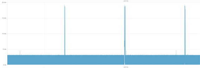

  • I'm also seeing spikes every 15 seconds, despite the fact nothing is happening.
    The config for ICD is
    CONFIG_CHIP_ICD_IDLE_MODE_DURATION=300
    CONFIG_CHIP_ICD_ACTIVE_MODE_DURATION=300
    CONFIG_CHIP_ICD_SLOW_POLL_INTERVAL=300000
    CONFIG_CHIP_ICD_FAST_POLLING_INTERVAL=500
    I'd expect to see the spikes at 30 second intervals, matching the SLOW_POLL_INTERVAL
    What NCS version are you using? Please check out this guide Reducing power consumption in Matter.
    Amanda H.
  • I'm using NCS 3.0.2
    I have followed that guide and made significant reductions. I'm not quite sure which setting removed the 500µA, but a pristine build resulted in the reduction.
    That said, I still have two issues which I need help with.
    #1 I have set CONFIG_CHIP_ICD_SLOW_POLL_INTERVAL to 30000, but as you can see in the PPKII graph above, the radio seems to turn on every 15 seconds.
    #2 There is a 3mA spike every one second. I have a single timer, configured to run at 10 second intervals. I configure the timer in AppTask::Init() and start it in AppTask::StartApp()
     To ensure that the SED device wakes up exactly at every poll period, set the following Kconfig options to the value greater than the poll period value (for Matter ICD CONFIG_CHIP_ICD_SLOW_POLL_INTERVAL):
    See Child timeouts configuration.
    Are you using the internal RC oscillator (CONFIG_CLOCK_CONTROL_NRF_K32SRC_RC=y)? If so, check out this post.

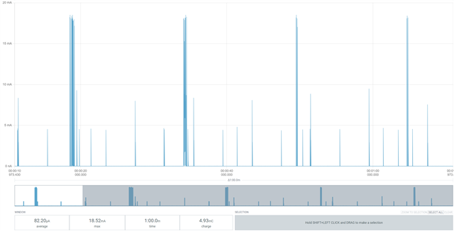

  • Thanks Amanda,
    I have checked the OPENTHREAD settings using menuconfig.
    CONFIG_OPENTHREAD_MLE_CHILD_TIMEOUT=240
    CONFIG_OPENTHREAD_CHILD_SUPERVISION_CHECK_TIMEOUT=190
    CONFIG_OPENTHREAD_CHILD_SUPERVISION_INTERVAL=129
    I believe this are the default values.
    I had actually removed the CONFIG_OPENTHREAD_MTD setting, so I restored that! D'oh!

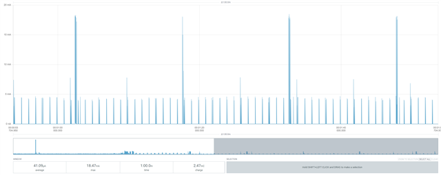

    That improved things. The one second spikes are gone now, but the radio is still turning on every 15 seconds, rather than 30.
    Unfortunately, setting CONFIG_CLOCK_CONTROL_NRF_K32SRC_RC_CALIBRATION to n as per the post resulted in a compilation error. I have got CONFIG_CLOCK_CONTROL_NRF_K32SRC_RC set to y.
