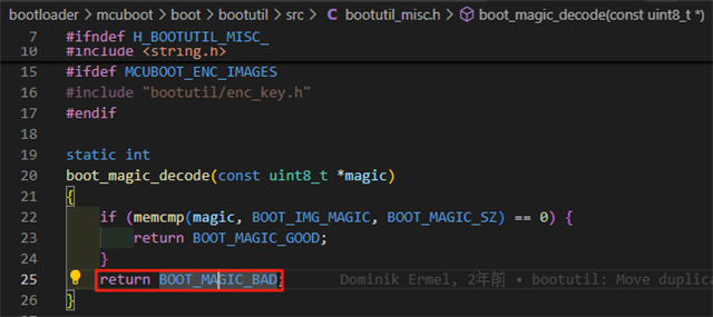

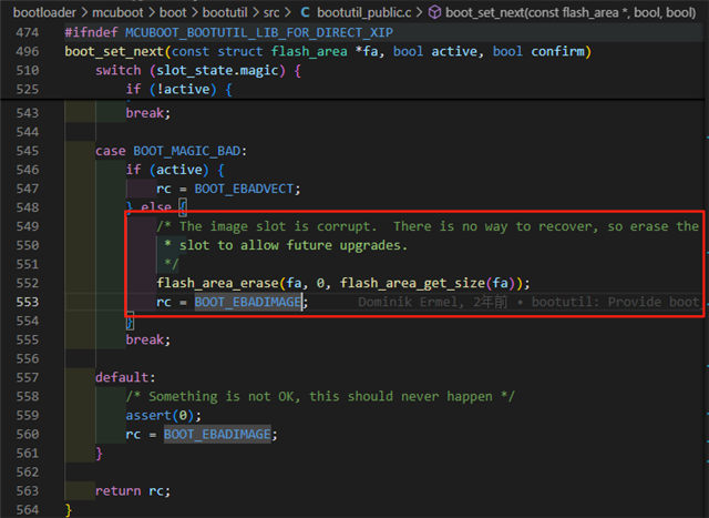

When I disabled the operation of encrypting the external flash, my Bluetooth upgrade was successful.
However, when I enabled the encryption operation, the Bluetooth upgrade failed.
After printing and checking, it was found that the magic failed to match and the upgrade was unsuccessful.
E: Faled boot_set_next with code 3, for slot 1, with active slot 0 and confirm 0
Will there be any problems with this encryption operation?
  • flash id :23, name:mx25r3235f@0, bootutil buffer is nooooooooooooooooooooooot erased, ready to decode magic
    magic:51, def_magic:77
    magic:7F, def_magic:C2
    magic:60, def_magic:95
    magic:E6, def_magic:F3
    magic:A9, def_magic:60
    magic:72, def_magic:D2
    magic:51, def_magic:EF
    magic:94, def_magic:7F
    magic:7B, def_magic:35
    magic:80, def_magic:52
    magic:EB, def_magic:50
    magic:53, def_magic:0F
    magic:33, def_magic:2C
    magic:E5, def_magic:B6
    magic:C9, def_magic:79
    magic:6C, def_magic:80
    [qspi_nor_read] ------------------
    boot_set_next: fa_id=23 active=0 confirm=0, magic=2

  • It's okay. I already know the reason for this problem.
    This is because the erasure operation does not go through the encryption engine. At this point, the data inside is 0xFF.
    Then, when using the read operation, the QSPI will automatically decrypt it, resulting in the value read out not being 0xFF anymore.
    Therefore, after the magic check, it is determined that the magic has been set. After decoding, detected incorrect in the values , so it is considered that it is an invalid and badimage.
