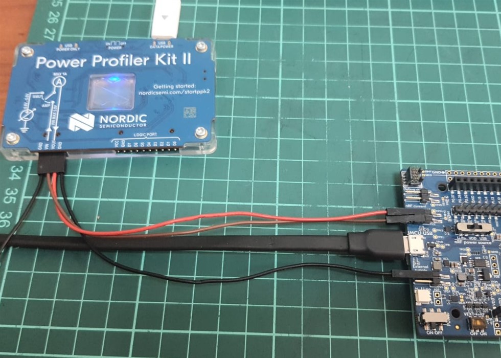

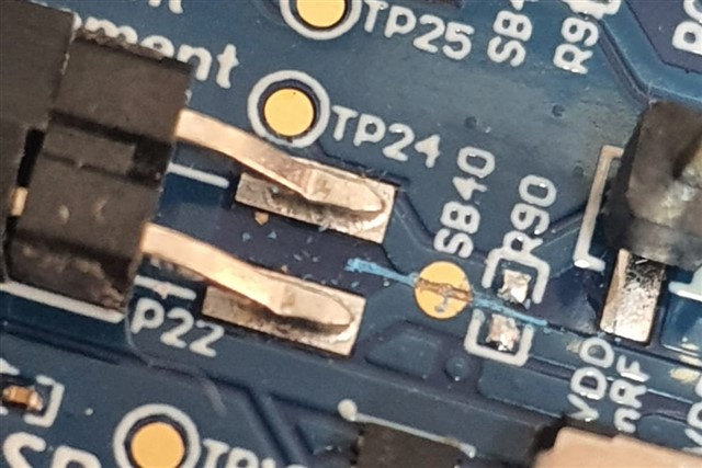

I cutted PCB track shorting solder bridge SB40.
I connected like this..

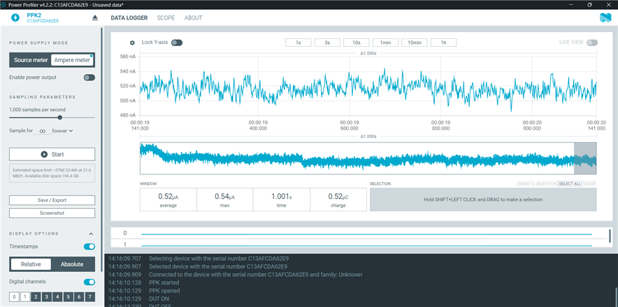

Then I opened power profile kit 2. I am using amperemeter..This is my app scrrenshot.
I flashed before blinky code to my 52840DK..
But led is not blinking..is this normal? Am I doing wrong?
By the way I Imade some attempts to measurment. Could I have caused harm? How can I check the integrity of the kit?

    Do make sure that you're doing measurements in the ampere meter mode. The connections look okay and follows what is described in the documentation.. Could you connect a jumper across P22 and see if you are able to detect the DK.? Perhaps re-flash the firmware onto the DK and see if it is working normally. (You need to flash a code onto the DK before cutting SB40 and make the connections as shown in the ppk2 documentation to take the current measurements.)
