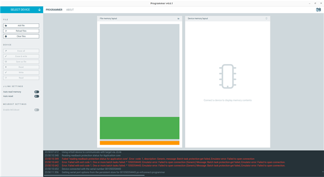

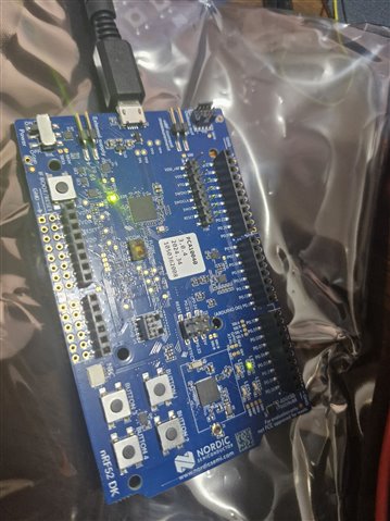

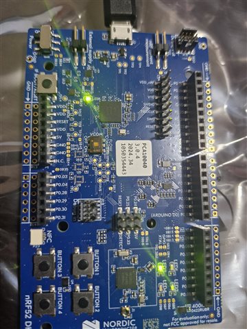

I purchased nRF52 DK 2 PCs. PCB labeled
PCA10040
3.0.4
2024.34
boath board are new and box packed. from first time itself. I am not able to flash the board. both device got error below.
both dk Boards nRF Connect Programmer Log files.

2025-07-12T17:18:36.118Z INFO Selecting device with the serial number 001050359820
2025-07-12T17:18:36.139Z DEBUG Sending event "programmer: running nrfutil device"
2025-07-12T17:18:36.449Z ERROR Error: Failed with exit code 1.
One or more device info tasks failed:
 * 1050359820: Device error: Setting the debug port SELECT register failed while powering up sys and debug regions (Unknown Error in J-Link DLL (error code =-1)).
   This might indicate that the debug port is unavailable. Please double-check device power supply and SWD lines, and that SWD isn't disabled (Generic)
Message: Operation device-info failed, Device error: Setting the debug port SELECT register failed while powering up sys and debug regions (Unknown Error in J-Link DLL (error code =-1)).
This might indicate that the debug port is unavailable. Please double-check device power supply and SWD lines, and that SWD isn't disabled.
2025-07-12T17:18:36.450Z INFO Selected device with the serial number 001050359820
2025-07-12T17:18:36.451Z INFO Using nrfutil device to communicate with target via JLink
2025-07-12T17:18:36.459Z DEBUG Sending event "programmer: device selected"
2025-07-12T17:18:36.460Z DEBUG Sending event "programmer: running nrfutil device"
2025-07-12T17:18:36.463Z INFO Update files regions according to Application core
2025-07-12T17:18:36.463Z INFO Parse memory regions for file
2025-07-12T17:18:36.577Z DEBUG Sending event "programmer: running nrfutil device"
2025-07-12T17:18:36.750Z INFO Reading readback protection status for Application core
2025-07-12T17:18:36.752Z INFO Reading readback protection status for Application core 0%
2025-07-12T17:18:36.876Z ERROR Failed "reading readback protection status for application core". Error: code: 1, description: Generic, message: Batch task protection-get failed, Device error: Setting the debug port SELECT register failed while powering up sys and debug regions (Unknown Error in J-Link DLL (error code =-1)).
2025-07-12T17:18:36.882Z ERROR Error: Failed with exit code 1.
One or more batch tasks failed:
Message: Batch task protection-get failed, Device error: Setting the debug port SELECT register failed while powering up sys and debug regions (Unknown Error in J-Link DLL (error code =-1)).

2025-07-12T17:19:37.648Z DEBUG Sending event "programmer: running nrfutil device"
2025-07-12T17:19:37.852Z DEBUG Sending event "programmer: running nrfutil device"
2025-07-12T17:19:37.855Z INFO Update files regions according to Application core
2025-07-12T17:19:37.855Z INFO Parse memory regions for file
2025-07-12T17:19:37.964Z DEBUG Sending event "programmer: running nrfutil device"
2025-07-12T17:19:38.052Z INFO Reading readback protection status for Application core
2025-07-12T17:19:38.052Z INFO Reading readback protection status for Application core 0%
2025-07-12T17:19:38.054Z INFO Reading readback protection status for Application core 100%
2025-07-12T17:19:38.055Z INFO Application core protection status 'NRFDL_PROTECTION_STATUS_NONE'
2025-07-12T17:19:38.055Z INFO Reading readback protection status for Application core completed
2025-07-12T17:19:38.182Z DEBUG Sending event "programmer: running nrfutil device"
2025-07-12T17:19:38.293Z DEBUG Sending event "programmer: running nrfutil device"
2025-07-12T17:19:38.381Z INFO Recovering Application core
2025-07-12T17:19:38.381Z INFO Recovering Application core 0%
2025-07-12T17:19:48.511Z INFO Recovering Application core 100%
2025-07-12T17:19:48.517Z INFO Recovering Application core completed

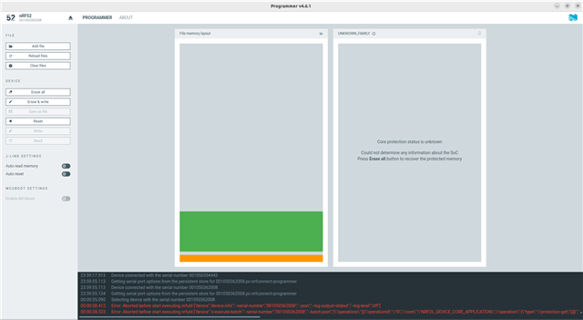

2025-07-12T17:34:33.572Z INFO Device connected with the serial number 001050359820
2025-07-12T17:34:33.597Z INFO Update files regions according to Application core
2025-07-12T17:34:33.597Z INFO Parse memory regions for file
2025-07-12T17:34:35.150Z INFO Getting serial port options from the persistent store for 001050359820.pc-nrfconnect-programmer
2025-07-12T17:34:35.153Z INFO Device connected with the serial number 001050359820
2025-07-12T17:34:35.158Z DEBUG Sending event "programmer: device connected"
2025-07-12T17:34:35.182Z INFO Getting serial port options from the persistent store for 001050359820.pc-nrfconnect-programmer
2025-07-12T17:34:35.183Z DEBUG Sending event "programmer: device connected"
2025-07-12T17:40:35.949Z INFO Device connected with the serial number DCEECBD78924
2025-07-12T17:40:39.098Z INFO Device connected with the serial number 001050359820
2025-07-12T18:10:12.027Z INFO Getting serial port options from the persistent store for 001050354443.pc-nrfconnect-programmer
2025-07-12T18:10:12.028Z INFO Device connected with the serial number 001050354443
2025-07-12T18:10:12.034Z DEBUG Sending event "programmer: device connected"
2025-07-12T18:10:12.044Z INFO Getting serial port options from the persistent store for 001050354443.pc-nrfconnect-programmer
2025-07-12T18:10:12.045Z DEBUG Sending event "programmer: device connected"
2025-07-12T18:12:25.691Z INFO Selecting device with the serial number 001050354443
2025-07-12T18:12:25.704Z DEBUG Sending event "programmer: running nrfutil device"
2025-07-12T18:12:35.844Z ERROR Error: Aborted before start executing nrfutil ["device","device-info","--serial-number","001050354443","--json","--log-output=stdout","--log-level","off"]
2025-07-12T18:12:35.851Z DEBUG Sending event "programmer: running nrfutil device"
2025-07-12T18:12:35.957Z ERROR Error: Aborted before start executing nrfutil ["device","x-execute-batch","--serial-number","001050354443","--batch-json","{\"operations\":[{\"operationId\":\"0\",\"core\":\"NRFDL_DEVICE_CORE_APPLICATION\",\"operation\":{\"type\":\"protection-get\"}}]}","--json","--log-output=stdout","--log-level","off"]
2025-07-12T18:12:40.030Z ERROR Error: Failed with exit code 1.
 * 1050354443: Timed out waiting for response from worker. (Generic)
Message: Operation device-info failed, Timed out waiting for response from worker.
2025-07-12T18:12:40.031Z INFO Selected device with the serial number 001050354443
2025-07-12T18:12:40.032Z INFO Using nrfutil device to communicate with target via JLink
2025-07-12T18:12:40.043Z DEBUG Sending event "programmer: device selected"
2025-07-12T18:12:40.043Z DEBUG Sending event "programmer: running nrfutil device"
2025-07-12T18:12:40.163Z DEBUG Sending event "programmer: running nrfutil device"
2025-07-12T18:12:43.024Z INFO Reading readback protection status for Application core
2025-07-12T18:12:43.024Z ERROR Failed "reading readback protection status for application core". Error: code: 1, description: Generic, message: Batch task protection-get failed, Emulator error: Failed to open connection
2025-07-12T18:12:43.073Z ERROR Error: Failed with exit code 1.
 * 1050354443: Emulator error: Failed to open connection (Generic)
Message: Batch task protection-get failed, Emulator error: Failed to open connection.
2025-07-12T18:12:43.134Z INFO Device connected with the serial number 001050354443
2025-07-12T18:12:44.029Z INFO Getting serial port options from the persistent store for 001050354443.pc-nrfconnect-programmer
2025-07-12T18:12:44.029Z INFO Device connected with the serial number 001050354443
2025-07-12T18:12:44.031Z DEBUG Sending event "programmer: device connected"
2025-07-12T18:12:44.052Z INFO Getting serial port options from the persistent store for 001050354443.pc-nrfconnect-programmer
2025-07-12T18:12:44.053Z DEBUG Sending event "programmer: device connected"
2025-07-12T18:12:50.494Z INFO Selecting device with the serial number 001050354443
2025-07-12T18:12:50.505Z DEBUG Sending event "programmer: running nrfutil device"
2025-07-12T18:13:04.849Z ERROR Error: Failed with exit code 1.
2025-07-12T18:13:04.849Z INFO Selected device with the serial number 001050354443
2025-07-12T18:13:04.850Z INFO Using nrfutil device to communicate with target via JLink
2025-07-12T18:13:04.856Z DEBUG Sending event "programmer: device selected"
2025-07-12T18:13:04.856Z DEBUG Sending event "programmer: running nrfutil device"
2025-07-12T18:13:04.971Z DEBUG Sending event "programmer: running nrfutil device"
2025-07-12T18:13:07.824Z INFO Reading readback protection status for Application core
2025-07-12T18:13:07.824Z ERROR Failed "reading readback protection status for application core". Error: code: 1, description: Generic, message: Batch task protection-get failed, Emulator error: Failed to open connection
2025-07-12T18:13:07.891Z ERROR Error: Failed with exit code 1.
2025-07-12T18:13:07.892Z ERROR Error: Failed with exit code 1.
2025-07-12T18:13:07.926Z INFO Device connected with the serial number 001050354443
2025-07-12T18:13:08.821Z INFO Getting serial port options from the persistent store for 001050354443.pc-nrfconnect-programmer
2025-07-12T18:13:08.821Z INFO Device connected with the serial number 001050354443
2025-07-12T18:13:08.822Z DEBUG Sending event "programmer: device connected"
2025-07-12T18:13:08.851Z INFO Getting serial port options from the persistent store for 001050354443.pc-nrfconnect-programmer
2025-07-12T18:13:08.852Z DEBUG Sending event "programmer: device connected"
2025-07-12T18:19:11.719Z INFO Selecting device with the serial number 001050354443
2025-07-12T18:19:11.745Z DEBUG Sending event "programmer: running nrfutil device"
2025-07-12T18:19:16.453Z ERROR Error: Aborted before start executing nrfutil ["device","device-info","--serial-number","001050354443","--json","--log-output=stdout","--log-level","off"]
2025-07-12T18:19:16.459Z DEBUG Sending event "programmer: running nrfutil device"
2025-07-12T18:19:16.565Z ERROR Error: Aborted before start executing nrfutil ["device","x-execute-batch","--serial-number","001050354443","--batch-json","{\"operations\":[{\"operationId\":\"0\",\"core\":\"NRFDL_DEVICE_CORE_APPLICATION\",\"operation\":{\"type\":\"protection-get\"}}]}","--json","--log-output=stdout","--log-level","off"]
2025-07-12T18:19:21.533Z ERROR Error: Aborted before start executing nrfutil ["device","device-info","--serial-number","001050354443","--json","--log-output=stdout","--log-level","off"]
2025-07-12T18:19:21.538Z DEBUG Sending event "programmer: running nrfutil device"
2025-07-12T18:19:21.642Z ERROR Error: Aborted before start executing nrfutil ["device","x-execute-batch","--serial-number","001050354443","--batch-json","{\"operations\":[{\"operationId\":\"0\",\"core\":\"NRFDL_DEVICE_CORE_APPLICATION\",\"operation\":{\"type\":\"protection-get\"}}]}","--json","--log-output=stdout","--log-level","off"]
2025-07-12T18:19:26.079Z ERROR Error: Failed with exit code 1.
2025-07-12T18:19:26.080Z INFO Selected device with the serial number 001050354443
2025-07-12T18:19:26.080Z INFO Using nrfutil device to communicate with target via JLink
2025-07-12T18:19:26.086Z DEBUG Sending event "programmer: device selected"
2025-07-12T18:19:26.087Z DEBUG Sending event "programmer: running nrfutil device"
2025-07-12T18:19:26.203Z DEBUG Sending event "programmer: running nrfutil device"
2025-07-12T18:19:29.008Z INFO Reading readback protection status for Application core
2025-07-12T18:19:29.009Z ERROR Failed "reading readback protection status for application core". Error: code: 1, description: Generic, message: Batch task protection-get failed, Emulator error: Failed to open connection
2025-07-12T18:19:29.011Z ERROR Error: Failed with exit code 1.
2025-07-12T18:19:29.118Z INFO Device connected with the serial number 001050354443
2025-07-12T18:19:30.002Z INFO Getting serial port options from the persistent store for 001050354443.pc-nrfconnect-programmer
2025-07-12T18:19:30.002Z INFO Device connected with the serial number 001050354443
2025-07-12T18:19:30.004Z DEBUG Sending event "programmer: device connected"
2025-07-12T18:19:30.025Z INFO Getting serial port options from the persistent store for 001050354443.pc-nrfconnect-programmer
2025-07-12T18:19:30.026Z DEBUG Sending event "programmer: device connected"
2025-07-12T18:19:53.247Z INFO Selecting device with the serial number 001050354443
2025-07-12T18:19:53.278Z DEBUG Sending event "programmer: running nrfutil device"
2025-07-12T18:20:07.611Z ERROR Error: Failed with exit code 1.
2025-07-12T18:20:07.611Z INFO Selected device with the serial number 001050354443
2025-07-12T18:20:07.612Z INFO Using nrfutil device to communicate with target via JLink
2025-07-12T18:20:07.618Z DEBUG Sending event "programmer: device selected"
2025-07-12T18:20:07.618Z DEBUG Sending event "programmer: running nrfutil device"
2025-07-12T18:20:07.734Z DEBUG Sending event "programmer: running nrfutil device"
2025-07-12T18:20:10.548Z INFO Reading readback protection status for Application core
2025-07-12T18:20:10.549Z ERROR Failed "reading readback protection status for application core". Error: code: 1, description: Generic, message: Batch task protection-get failed, Emulator error: Failed to open connection
2025-07-12T18:20:10.642Z ERROR Error: Failed with exit code 1.
2025-07-12T18:20:10.653Z INFO Device connected with the serial number 001050354443
2025-07-12T18:20:11.556Z INFO Getting serial port options from the persistent store for 001050354443.pc-nrfconnect-programmer
2025-07-12T18:20:11.556Z INFO Device connected with the serial number 001050354443
2025-07-12T18:20:11.558Z DEBUG Sending event "programmer: device connected"
2025-07-12T18:20:11.577Z INFO Getting serial port options from the persistent store for 001050354443.pc-nrfconnect-programmer
2025-07-12T18:20:11.578Z DEBUG Sending event "programmer: device connected"
2025-07-12T18:32:09.272Z INFO Initialising the bundled nrfutil device
2025-07-12T18:32:09.286Z DEBUG Application data folder: /home/parths/.config/nrfconnect/pc-nrfconnect-programmer
2025-07-12T18:32:09.323Z DEBUG Sending event "programmer: running nrfutil device"
2025-07-12T18:32:09.342Z DEBUG App pc-nrfconnect-programmer v4.6.1 (official)
2025-07-12T18:32:09.342Z DEBUG App path: /home/parths/.nrfconnect-apps/node_modules/pc-nrfconnect-programmer
2025-07-12T18:32:09.342Z DEBUG nRFConnect 5.2.0, required by the app is (>=5.2.0)
2025-07-12T18:32:09.342Z DEBUG nRFConnect path: /tmp/.mount_nrfconneBEPc/resources/app.asar
2025-07-12T18:32:09.342Z DEBUG HomeDir: /home/parths
2025-07-12T18:32:09.342Z DEBUG TmpDir: /tmp
2025-07-12T18:32:09.414Z DEBUG Sending event "programmer: running nrfutil device"
2025-07-12T18:32:09.420Z DEBUG Sending event "programmer: running nrfutil device"
2025-07-12T18:32:09.423Z INFO Using the bundled core version for nrfutil device: 8.0.0
2025-07-12T18:32:09.452Z INFO Getting serial port options from the persistent store for 001050362008.pc-nrfconnect-programmer
2025-07-12T18:32:09.453Z INFO Device connected with the serial number 001050362008
2025-07-12T18:32:09.454Z DEBUG Sending event "programmer: device connected"
2025-07-12T18:32:09.516Z INFO Using nrfutil-device version: 2.12.3
2025-07-12T18:32:09.516Z INFO Using nrf-device-lib version: 0.17.81
2025-07-12T18:32:09.516Z INFO Using nrf-probe version: 0.40.1
2025-07-12T18:32:09.517Z INFO Using JLink version: JLink_V8.18
2025-07-12T18:32:11.099Z INFO Selecting device with the serial number 001050362008
2025-07-12T18:32:11.120Z DEBUG Sending event "programmer: running nrfutil device"
2025-07-12T18:32:15.812Z INFO Parsing HEX file:  /home/parths/Desktop/github_261/SmartBottle/build/zephyr/old_release_SDK261.hex
2025-07-12T18:32:15.831Z INFO File was last modified at  02/07/2025, 01:31:04
2025-07-12T18:32:15.881Z INFO Update files regions according to Application core
2025-07-12T18:32:15.881Z INFO Parse memory regions for file
2025-07-12T18:32:16.891Z DEBUG Sending event "programmer: running nrfutil device"
2025-07-12T18:32:17.002Z ERROR Error: Failed with exit code 1.
 * 1050362008: Emulator error: Failed to open connection (Generic)
Message: Operation device-info failed, Emulator error: Failed to open connection.
2025-07-12T18:32:17.013Z DEBUG Sending event "programmer: running nrfutil device"
2025-07-12T18:32:17.018Z INFO Update files regions according to Application core
2025-07-12T18:32:17.018Z INFO Parse memory regions for file
2025-07-12T18:32:17.131Z DEBUG Sending event "programmer: running nrfutil device"
2025-07-12T18:32:17.185Z INFO Reading readback protection status for Application core
2025-07-12T18:32:17.185Z ERROR Failed "reading readback protection status for application core". Error: code: 1, description: Generic, message: Batch task protection-get failed, Emulator error: Failed to open connection
2025-07-12T18:32:17.239Z ERROR Error: Failed with exit code 1.
2025-07-12T18:32:25.442Z ERROR Error: Failed with exit code 1.
 * 1050362008: Timed out waiting for response from worker. (Generic)
2025-07-12T18:32:25.443Z INFO Selected device with the serial number 001050362008
2025-07-12T18:32:25.444Z INFO Using nrfutil device to communicate with target via JLink
2025-07-12T18:32:25.455Z DEBUG Sending event "programmer: device selected"
2025-07-12T18:32:25.456Z DEBUG Sending event "programmer: running nrfutil device"
2025-07-12T18:32:25.577Z DEBUG Sending event "programmer: running nrfutil device"
2025-07-12T18:32:28.397Z INFO Reading readback protection status for Application core
2025-07-12T18:32:28.398Z ERROR Failed "reading readback protection status for application core". Error: code: 1, description: Generic, message: Batch task protection-get failed, Emulator error: Failed to open connection
2025-07-12T18:32:28.494Z ERROR Error: Failed with exit code 1.

i think this issue with the perticuler batch version 2024.34, because same nRF52 DK board PCB Version 2024.44 batch working fine!.
please help me out from this flashing issu.
