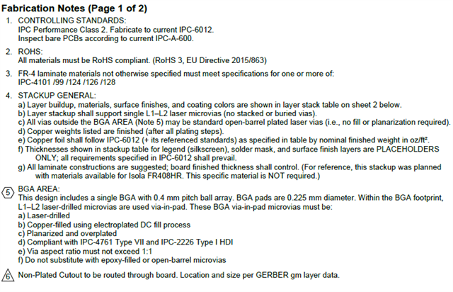

In addition to all of this, I want to be very clear about specifying the board is generally class 2 but requires special considerations for the nRF5340 only. Here's what I have in my draft fabrication notes as of right now specifically related to this:
General Construction Notes
  • Build to IPC-6012 Class 2 performance requirements unless otherwise specified.
  • Layer stackup shall support single L1–L2 laser microvias (no stacked or buried vias).
  • All vias outside of the BGA area may be standard open-barrel plated laser vias (i.e., no fill or planarization required).
BGA Area (HDI Exception Handling)
  • This design includes a single BGA with 0.4 mm pitch ball array. BGA pads are 8.858 mil diameter (circular).
  • Within the BGA footprint, L1–L2 laser-drilled microvias are used via-in-pad.
  • These BGA via-in-pad microvias must be:
    • Laser-drilled
    • Copper-filled using electroplated DC fill process
    • Planarized and overplated
    • Compliant with IPC-4761 Type VII and IPC-2226 Type I HDI
    • Via aspect ratio must not exceed 1:1
    • Do not substitute with epoxy-filled or open-barrel microvias

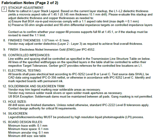

Stackup Adjustment Request
  • Based on the current layer stackup, the L1–L2 dielectric thickness yields a microvia aspect ratio of 1.45:1 (via drill = 3.937 mil, pad = 10 mil).
  • Please evaluate this stackup and adjust dielectric thickness and copper thicknesses as needed to:
    • Ensure that BGA via-in-pad microvias comply with a 1:1 aspect ratio limit (max depth = 3.937 mil)
    • Preserve 50-ohm single-ended and 90-ohm differential impedance targets on controlled impedance layers
  • Contact us to confirm whether your copper-fill process supports full fill at 1.45:1, or if the stackup must be revised to meet the 1:1 limit.

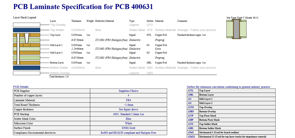

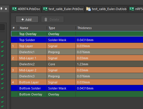

    In them in Altium you'll find the stack up like this one:
    We have 0.1mm microvia holes.
    We have 0.76mm between top and mid layer 1 in the stack up. 0.100mm is not a concern, only check the impedance calculations where that is important.

    Q2. Typically, laser microvias with aspect ratios larger than 1:1 are difficult to fill and plate. My vendor listed 1:1 as a limit on their capabilities sheet. The stack-up for the 7002DK creates a 1.45:1 L1-L2 laser microvia if you add up the thicknesses:
    L1 + Dielectric + L2 = 0.039 + 0.076 + 0.03 = 0.145mm numerator
    The denominator is the hole size = 4 mil = 0.1016mm
    So, the aspect ratio for the microvia with this stackup is 0.145 / 0.1016 = 1.43:1 which exceeds 1:1.

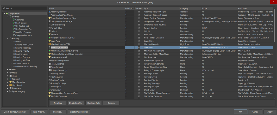

    There's a rules section in Altium, but it's not this that you are looking for?

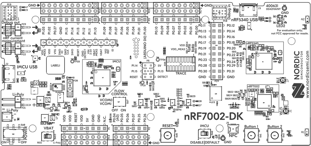

    Just since you write fabrication drawing. This is what we refer to as assembly drawing>
    Is any of this the right information for you?
