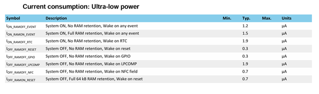

I am using the same hardware, and firmware on 4 custom boards of the same device. I observed that I am getting different current consumptions in each devices.
I am using nrf52833 device, with normal sleep.
Device1 3.2 uA
Device2 4.0 uA
Device3 3.7 uA
Device4 3.9 uA
Device5 3.5 uA
Is this normal to have these kind of differences ?
    Yes, the variation is within the normal System ON sleep current distribution for the nRF52833. It seems like the numbers may be a little bit on the high side compared to the PS, but there may be other factors for that. The PS numbers are also measured at 25 C.

    I am using the Wake up from SYSTEM_ON mode through RTC and GPIO wakeup pin(if the switch is pressed).
    According to the datasheet, for SYSTEM_ON mode, the current consumption is 1.9 uA for wakeup through RTC.
    But I am getting 2.5 uA on the device (This is a custom board and I removed all peripherals on it).
    How should I reduce this current?
    Note : The table I showed before was the device with all peripherals intact .
