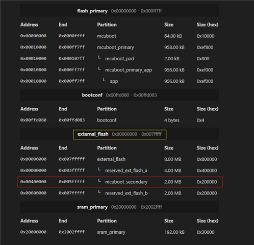

  1. Is it possible to allocate only 2 MB of external flash for the MCUboot secondary partition, or does MCUboot require full control of the entire external flash device?
  2. Can we manually define the offset and size of the secondary partition within the external flash? For example, can we assign the DFU secondary partition to a specific 2 MB region (e.g., from 0x400000 to 0x5FFFFF)?

    Yes, it is possible to allocate a specific region of external flash for the secondary slot. MCUBoot does not require full control of the external flash; it only needs access to the defined region.
    I’m sharing a sample based on the Academy example you checked, where I included a pm_static file that assigns the secondary slot as you mentioned. See the screenshot below and review the pm_static file included in the sample. The sample is built for nrf54l15dk/nrf54l10/cpuapp.

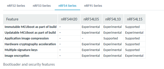

    I don't think there is any limitation when the secondary slot is moved to external flash. However, please note that MCUBoot with the nRF54L10 is in an experimental state and may not be fully supported.
