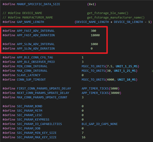

I am using the S312 protocol stack on nrf52810, with both BLE and ANT+enabled, to transmit heart rate. It can be used on most devices, but it is difficult to connect to 'wahoo elemnt bolt' when using BLE: connection timeout. I am using a broadcast interval of 300 * 0.625. What could be the possible reason? thank。
this is my ble config
    It seems the BLE connection timeout issue only happens while connecting to the 'wahoo elemnt bolt'. Maybe the central device (Wahoo BOLT) may have a timeout window too short to catch advertisements at 187.5 ms(your broadcast interval of 300 * 0.625), so the Wahoo BOLT may expect more frequent advertisements to quickly find and initiate connection with peripherals (especially fitness sensors). Then, you could try to set adv_interval to 25 ms as our example (nRF5_SDK\examples\multiprotocol\ble_ant_app_hrm)
    You can use nRF Sniffer or a BLE packet sniffer to confirm if the advertisements are being sent and how frequently. Also, check if the Wahoo BOLT connects easily to other commercial HR monitors – if yes, compare their advertisement intervals and payload content.

  • Thank you for your reply. There is a key issue. When I turn off ANT+, ble always connects successfully,
