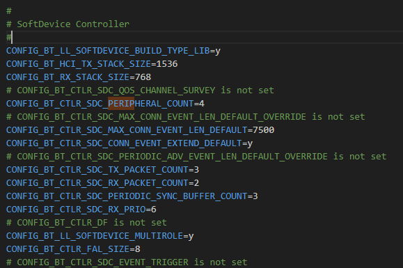

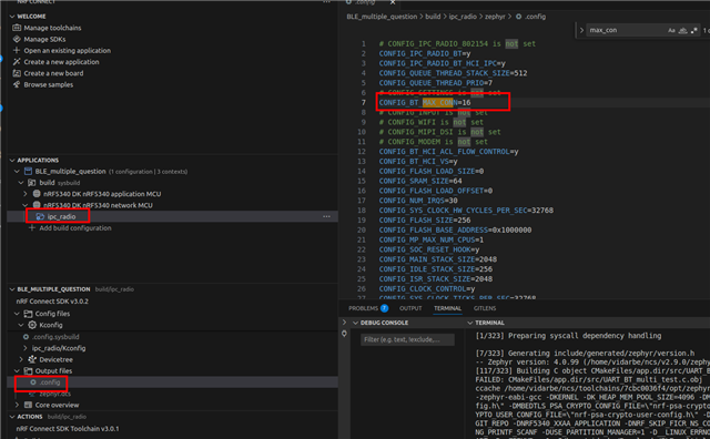

  • So finally there was necessary to set:
    CONFIG_BT_CENTRAL=n
    in the ipc_radio.conf, then it can be compiled. The config seems to be right in the network colee comiled file .config:
    But the next device cannot connect to the 5340-DK and read/write data (advertising is stopped after connection of first device). Couldn't be problem in the program - I'm using unchanged Peripheral_UART sample. Can you please advise me?
    Thank you
