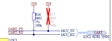

We want to use the UART in low power mode and therefore, we have used the zephyr,pm-device-runtime-auto flag in the DTS uart configuration. Also, we want to have the RX pin of the UART disabled. However, we see increased current consumption in the following scenario.
- When the UART is configured in the .dts file without the disable-rx flag, the current consumption of the device is 0.6mA.
- When UART is configured including the disable-rx flag, the current consumption is 1.5mA.
Therefore, it seems that using the disable-rx flag results in the UART not going into low power mode.
- Our UART RX pin has an external pull up resistor as you can see in the image attached.
I provide the pinctrl.dtsi UART configuration and the .dts file UART configuration.

Is there a specific reasoning or configuration we need to follow to be in low power mode and have the UART RX disabled at the same time?
  • It seems like the disable-rx is not doing what we expect it to do.
    Without disable-rx, the driver seems to leave the channel running
    With disable-rx, the driver never queues RX so I think it never calls the power management plugs to shut down the hardware.

  • The main problem we are dealing with is that without the use of the disable-rx flag the software crashes at some point, waiting indefinitely in the while loop in the uart_nrfx_uarte.c file, in the uarte_pm_suspend() function.
    If we use the disable-rx flag, the code is not stuck anymore in the following while loop but the current consumption is really high.
