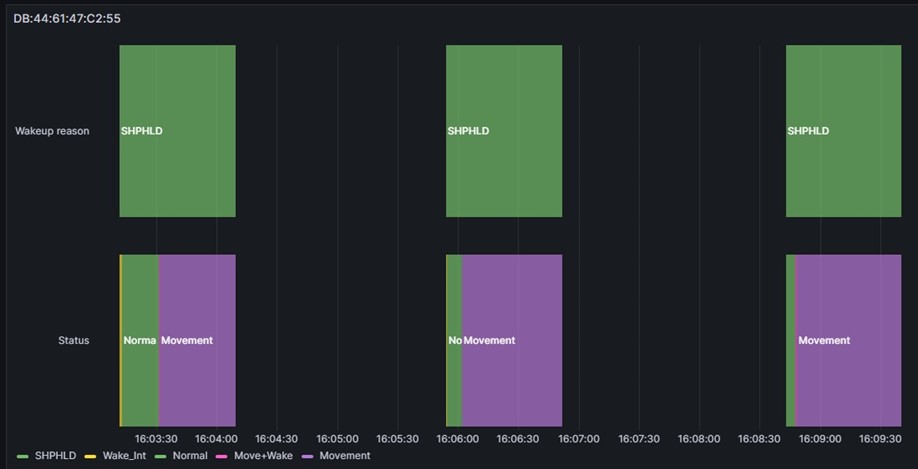

When the SHPHLD pin is already high before entering Hibernate, the nPM2100 immediately wakes up, even though no edge transition occurred. This seems to contradict the expected edge-based wakeup behavior.
To eliminate external factors:
  • I replaced the vibration sensor with a mechanical switch (same logic behavior).
  • No bounce or glitches were observed.
  • Wakeup occurs immediately if SHPHLD is already high when Hibernate is entered.
Attached you’ll find two charts:
 Chart with upwards trend Figure 1: Shows the SHPHLD wakeup trigger occurring without any edge transition at Hibernate entry (Rising-Edge configuration).

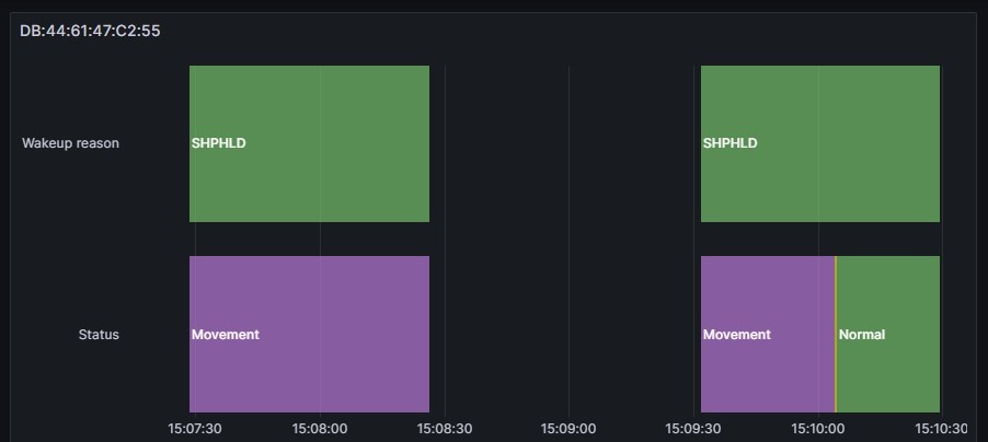

Chart with upwards trend Figure 2: Same scenario with Falling-Edge configuration (0xC2 = 0) — no false wakeups occur. Behavior is now correct and stable.
This leads me to believe that:
The nPM2100 may internally default to a low reference state for SHPHLD edge detection during Hibernate entry. If the pin is already high, this is interpreted as a Rising Edge, triggering a wakeup immediately.
This behavior is not described in the nPM2100 Product Specification.
White check mark Temporary workaround:
I switched to Falling-Edge detection and inverted the logic. This now works reliably.
