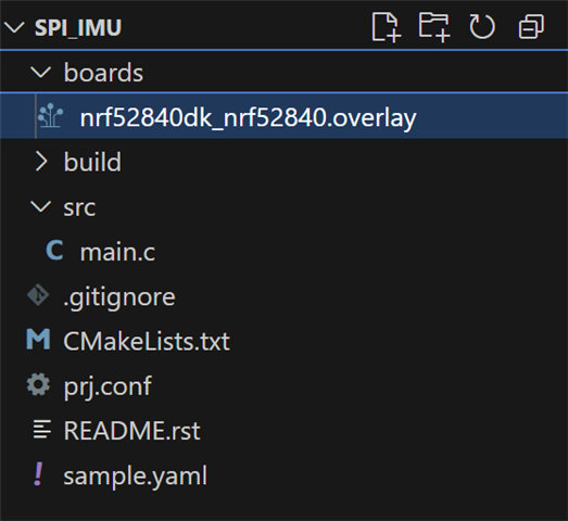

Hi, I just tried to connect LSM6DSV IMU with nRF52840dk
The whole folder structure is shown below :
1. I set nrf52840dk_nrf52840.overlay file first.

2. I set main.c as below also :
but I failed to get proper WHO_AM_I result from the sensor. Every pin was properly connected.

I tried to switch to SPI mode.
But I still don't know why my code is not working..
Is there any proper solution for this problem? Thanks in advance
