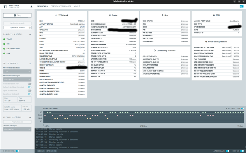

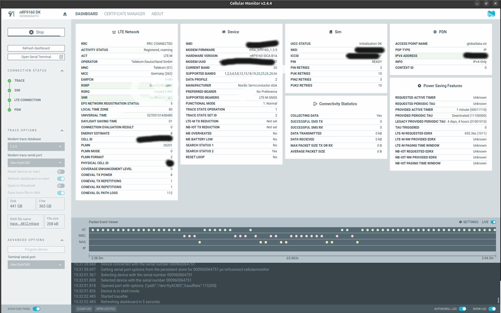

What works is when I use cellular monitor v2.4.4 and flash the DK under the advanced options with the pre compiled .hex:

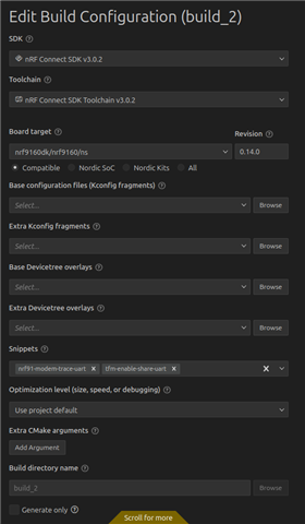

Now I want to do the same but instead of pre compiled I want to build from source of modem_shell example. According to the doc I use both snippets nrf91-modem-trace-uart and tfm-enable-share-uart:
It builds and i can flash it. But the trace is not complete as many fields are "unknown":

How can i ensure all data is traced?
And why is the connection quality poor for the source build?
