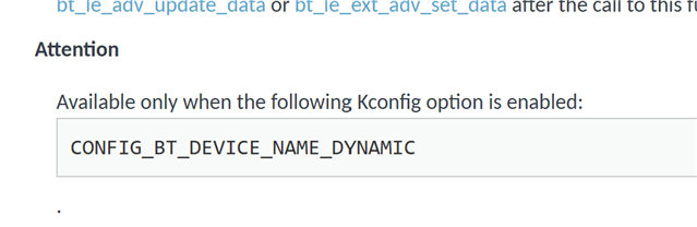

    You could maybe try to update the device name in your application ( in your prj.conf ) or directly in the source code using the Zephyr Bluetooth API.
    Say, you can set the device name in prj.conf:
    CONFIG_BT_DEVICE_NAME="YourNewDeviceName"
    Or you can set it at runtime in your code using:
    bt_set_name("YourNewDeviceName");
    PLease keep in mind when using the bt_Set_name:
