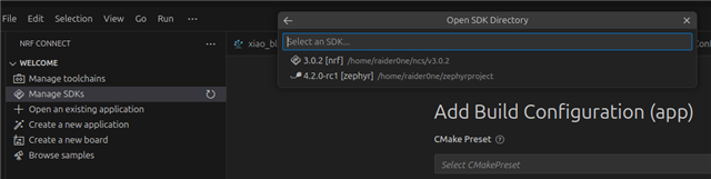

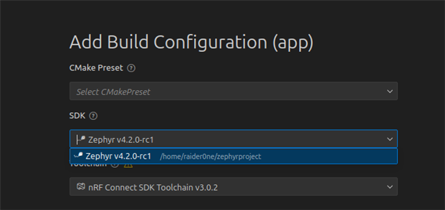

After this installed NCS in the same machine using the VS Code extension. I am unable to select the correct SDK location as the add build configuration screen only detects the zephyr installation I made and not the NCS SDK installation.
The Manage SDK Menu correctly detects both SDK installations
The build fails when I try to build using the pure zephyr SDK. The build happens as expected when I set the correct SDK and toolchain as ENV vars in a terminal.

  • I have resolved the issue for now. I think the cause of the issue was that the project was a workspace application and was in the same folder as the Zephyr workspace folder. NCS showed up when I moved the application to the ncs folder (the parent folder where toolchain, SDK etc  are all present). Still does not fully explain why the extension did not detect the NCS installation. Is this the expected behaviour or a bug?
