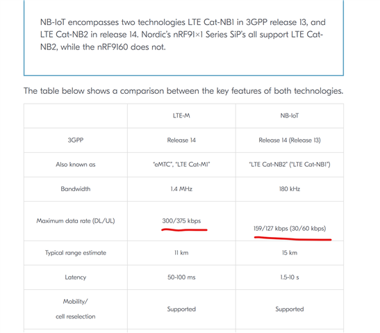

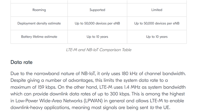

  • Thanks Priyanka,
    It would be useful for this performance info to be in the chip datasheet rather than just in the academy training documents.
    I have noticed that many IoT modems report different achievable data rates, and the LTE-CatM information I have seen suggests the standard supports higher data rates (e.g. Quectel BG95 and Quectel BG96 both support MTE-CatM, but with different possible data rates, and some summary documents support a maximum of 1mbps, presumably with higher power consumption and more air time).
    Is the throughput on the nRF9151 a hardware limit? Or a limit of processing performance?
