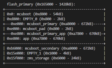

I tried to tag it on to the end of settings_storage, with this pm_static.yml:
zms_storage:
address: 0x15f000
end_address: 0x165000
placement:
before:
- end
region: flash_primary
This results in the following partition.yml:
app:
address: 0x0
end_address: 0x163000
otp:
address: 0xffd500
end_address: 0xffd9fc
region: otp
settings_storage:
address: 0x163000
placement:
after:
- app
before:
- end
sram_primary:
address: 0x20000000
end_address: 0x2002f000
region: sram_primary
zms_storage:
address: 0x165000
end_address: 0x16b000
placement:
before:
- end
I also made the following modification to the zms code, to use the defined zms_storage:

However, when I run my code, the following line fails:
rc = flash_get_page_info_by_offs(fs.flash_device, fs.offset, &info);
(fs.offset is 0x165000)
I get error -22.

  • Hi
    That seems to work for me too.
    So, what is the logic behind defining the location?
    Before I added ZMS, this was the info (excluding otp and sram) in partition.yml:
    app:
      address: 0x0
    settings_storage:
      address: 0x163000
      placement:
      after:
      - app
      before:
      - end
    and this was your suggestion for ZMS placement:
    zms_storage:
      address: 0x15f000
    So would I be correct in saying that, generally, we fitted the zms_storage to end at the end of settings_storage, whereas I had been trying to place the zms storge to start after settings_storage.
    Is that the general logic to apply?
    --> To see where the end of used/defined Flash memory is, and fit the ZMS storage to end there, which will in turn, push one or two other storage areas to start at a lower address etc.
    Thanks
