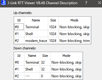

    Can you show how you enable tracing over UART and RTT?
    You can read more about modem tracing and modem trace module in the documentation.
    Dejan
  • I don't know, how Mathieu enabled the modem trace, in my test I did it with the snippets "west build -S nrf91-modem-trace-uart ..." and "west build -S nrf91-modem-trace-rtt ...".
    With the UART it works, with RTT I wasn't able to get the trace and got only warnings in the logging console instead.
    NCS 2.9.2, nRF9151-DK, mfw 2.0.2.
    Ubuntu, JLinkRTTLogger V8.18
    nrfjprog --reset && JLinkRTTLogger -Device NRF9151_XXCA -If SWD -Speed 50000  modemtracesrtt.bin
    (As already mentioned above.)

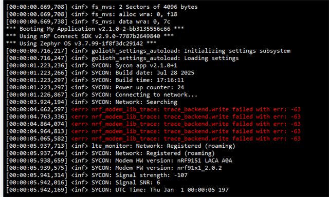

    We were not able to get modem traces. I was not able to do it with UART1, since the uart1 is used for other purposes, and the connectivy_bridge is not used anymore. That's why we redirect all our app uart to RTT.
    So, i tried to use the RTT modem trace snippet.
    I also get the -63 error.
    By the way, i get nothing on channel 2, about modem traces. It remains empty
    Here is the command i used to build
    of course, i used the link given for the snippet.
    Well, it seems i won't be able to get some modem traces :)

  • > EMM cause: 7
    => "EPS not allowed"
    And that log is no modem trace ;-).
  • This happens when i deactivate the sim manually, So this one is okay and happens as expected ;)Slight smile but the problem occurs after that
  • But you will still need to provide a modem trace for that case.
