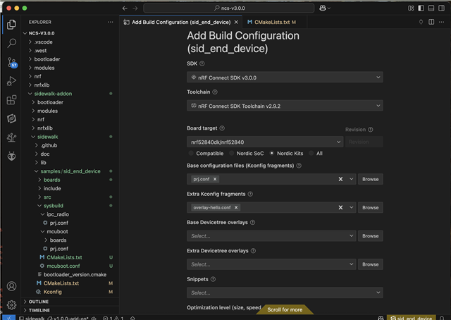

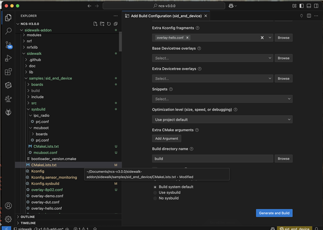

CMake Error at /Users/huydf/Documents/ncs-v3.0.0/zephyr/cmake/modules/kconfig.cmake:327 (message): File not found: /Users/huydf/Documents/ncs-v3.0.0/sidewalk-addon/sidewalk/samples/sid_end_device/sy
CMake cannot find prj.conf file in sysbuild directory
I want to build ncs v3.0.0 using sidewalk samples " hello " to build for nRF52840 board. I use nRF Extension as a build tool
This is the error i am dealing with. Hope you guys will help me to deal with this error. Thanks !

    Prj.conf file should be inside the sample folder (/Users/huydf/Documents/ncs-v3.0.0/sidewalk-addon/sidewalk/samples/sid_end_device/prj.conf); not inside the sysnuild folder. If you need configuration for sysbuild, then you need add sysbuild.conf file inside the sysbuild folder.

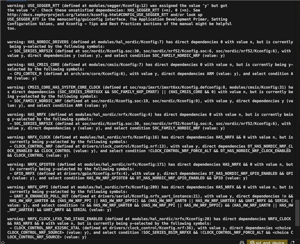

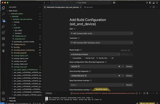

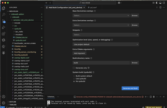

  • Hi sir !
    I tried building with the option not to use sysbuild and it gives me the error below, I tried updating the SDK and Toolchain using nRF Connect for Desktop but it doesn't seem to work.

    warning: USE_SEGGER_RTT (defined at modules/segger/Kconfig:12) was assigned the value 'y' but got
    the value 'n'. Check these unsatisfied dependencies: HAS_SEGGER_RTT (=n), 0 (=n). See
    docs.zephyrproject.org/.../kconfig.html and/or look up
    USE_SEGGER_RTT in the menuconfig/guiconfig interface. The Application Development Primer, Setting
    Configuration Values, and Kconfig - Tips and Best Practices sections of the manual might be helpful
    too.
    warning: HAS_NORDIC_DRIVERS (defined at modules/hal_nordic/Kconfig:7) has direct dependencies 0 with value n, but is currently being y-selected by the following symbols:
    - SOC_SERIES_NRF52X (defined at soc/nordic/Kconfig.soc:30, soc/nordic/nrf52/Kconfig.soc:6, soc/nordic/nrf52/Kconfig:6), with value y, direct dependencies y (value: y), and select condition SOC_FAMILY_NORDIC_NRF (value: y)
    warning: HAS_CMSIS_CORE (defined at modules/cmsis/Kconfig:7) has direct dependencies 0 with value n, but is currently being y-selected by the following symbols:
    - CPU_CORTEX_M (defined at arch/arm/core/Kconfig:6), with value y, direct dependencies ARM (value: y), and select condition ARM (value: y)
    warning: CMSIS_CORE_HAS_SYSTEM_CORE_CLOCK (defined at soc/nxp/imxrt/imxrt6xx/Kconfig.defconfig:8, modules/cmsis/Kconfig:31) has direct dependencies (SOC_SERIES_IMXRT6XX && SOC_FAMILY_NXP_IMXRT) || (HAS_CMSIS_CORE && 0) with value n, but is currently being y-selected by the following symbols:
    - SOC_FAMILY_NORDIC_NRF (defined at soc/nordic/Kconfig.soc:19, soc/nordic/Kconfig:9), with value y, direct dependencies y (value: y), and select condition ARM (value: y)
    warning: HAS_NRFX (defined at modules/hal_nordic/nrfx/Kconfig:4) has direct dependencies 0 with value n, but is currently being y-selected by the following symbols:
    warning: NRFX_CLOCK (defined at modules/hal_nordic/nrfx/Kconfig:16) has direct dependencies HAS_NRFX && 0 with value n, but is currently being y-selected by the following symbols:
    - CLOCK_CONTROL_NRF (defined at drivers/clock_control/Kconfig.nrf:13), with value y, direct dependencies DT_HAS_NORDIC_NRF_CLOCK_ENABLED && CLOCK_CONTROL (value: y), and select condition !CLOCK_CONTROL_NRF_FORCE_ALT && DT_HAS_NORDIC_NRF_CLOCK_ENABLED && CLOCK_CONTROL (value: y)
    warning: NRFX_GPIOTE0 (defined at modules/hal_nordic/nrfx/Kconfig:171) has direct dependencies HAS_NRFX && 0 with value n, but is currently being y-selected by the following symbols:
    - GPIO_NRFX (defined at drivers/gpio/Kconfig.nrfx:4), with value y, direct dependencies DT_HAS_NORDIC_NRF_GPIO_ENABLED && GPIO (value: y), and select condition HAS_HW_NRF_GPIOTE0 && DT_HAS_NORDIC_NRF_GPIO_ENABLED && GPIO (value: y)
    warning: NRFX_GPPI (defined at modules/hal_nordic/nrfx/Kconfig:209) has direct dependencies HAS_NRFX && 0 with value n, but is currently being y-selected by the following symbols:
    - UART_0_ENHANCED_POLL_OUT (defined at drivers/serial/Kconfig.nrfx_uart_instance:21), with value y, direct dependencies !n && HAS_HW_NRF_UARTE0 && (HAS_HW_NRF_PPI || HAS_HW_NRF_DPPIC) && (HAS_HW_NRF_UART0 || HAS_HW_NRF_UARTE0) && UART_NRFX && SERIAL (value: y), and select condition !n && HAS_HW_NRF_UARTE0 && (HAS_HW_NRF_PPI || HAS_HW_NRF_DPPIC) && (HAS_HW_NRF_UART0 || HAS_HW_NRF_UARTE0) && UART_NRFX && SERIAL (value: y)
    warning: NRFX_CLOCK_LFXO_TWO_STAGE_ENABLED (defined at modules/hal_nordic/nrfx/Kconfig:20) has direct dependencies NRFX_CLOCK && HAS_NRFX && 0 with value n, but is currently being y-selected by the following symbols:
    - CLOCK_CONTROL_NRF_K32SRC_XTAL (defined at drivers/clock_control/Kconfig.nrf:36), with value y, direct dependencies <choice CLOCK_CONTROL_NRF_SOURCE> (value: y), and select condition !SOC_SERIES_BSIM_NRFXX && !CLOCK_CONTROL_NRF_FORCE_ALT && <choice CLOCK_CONTROL_NRF_SOURCE> (value: y)
    Parsing /Users/huydf/Documents/ncs-v3.0.0/sidewalk-addon/sidewalk/samples/sid_end_device/Kconfig
    Loaded configuration '/Users/huydf/Documents/ncs-v3.0.0/zephyr/boards/nordic/nrf52840dk/nrf52840dk_nrf52840_defconfig'
    Merged configuration '/Users/huydf/Documents/ncs-v3.0.0/sidewalk-addon/sidewalk/samples/sid_end_device/prj.conf'
    Merged configuration '/Users/huydf/Documents/ncs-v3.0.0/sidewalk-addon/sidewalk/samples/sid_end_device/overlay-hello.conf'
    error: Aborting due to Kconfig warnings
    too.
