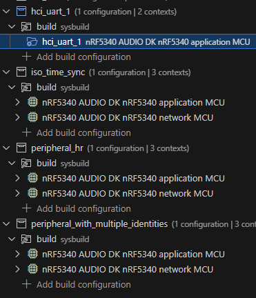

Why can other programs sysbuild compile two hex, one application mcu and one network mcu, but hci uart only has one application mcu?

    In hci_uart, it only targets the application core. The network core is not used in this sample, so only one HEX file is generated. Other programs, you get two HEX files: one for the application MCU (app core) and one for the network MCU (net core).

    As mentioned in this ticket, is there any particular reason why you need to split the controller and host between two nRF5340 devices? With its dual core design the nRF5340 is optimized to run the controller on the network core and the host on the application core. Though what you aim for might be possible for the nRF5340DK, I doubt it's possible on the nRF5340 Audio DK.
    For the nRF5340DK, you should be able to build the hci_uart sample, just like you build any other sample, i.e. use the hci_uart sample from zephyr/samples/bluetooth/hci_uart.
    And then build the sample targeting the network core (nrf5340dk_nrf5340_cpunet).
    After that you can flash the DK using:
    nrfjprog -f NRF53 --coprocessor CP_NETWORK --program build/zephyr/zephyr.hex --chiperase
