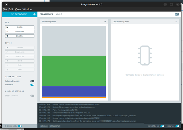

if I locate my code at x027000 (S140) for the softdevice blob to be at 0,
and use both files in the NRF Connect programmer, the layout looks as expected with the correct location and sizes
but it doesn't setup as expected (without debugging) which means I have a bug somewhere (not unexpected)
