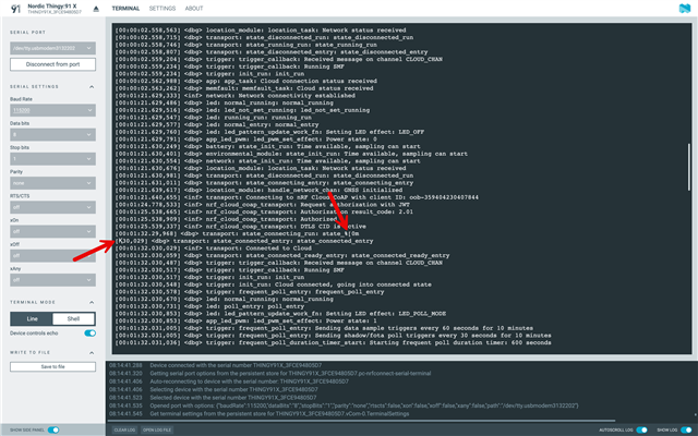

I'm seeing garbled/malformed UART console output when running apps on the Thingy:91 X. This includes pre-built apps from Nordic and custom apps I build myself.
Here's an example running the pre-built thingy91x_hello.nrfcloud.com_v2.0.2.hex binary from Nordic:

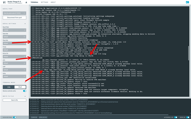

Here's another example running the pre-compiled Thingy:91 Example app from Golioth:
I'm seeing the same behavior on multiple Thingy:91 X devices on different host machines (both Mac and Windows).
Any idea what might be causing this issue? Could this be an issue with the Connectivity Bridge firmware on the nRF53?
  • You could try to use USB to TTL converter to check if you get the same output.
    Just from my ticket:
    I put my app in nearly the same version on a Thingy:91X and a nRF9151-DK (same NCS version, different board supports).
    "Ghost-chars" on the Thingy:91X on "faster output".
    No such "Ghost-chars" on the nRF9151-DK, even on "faster output".
    Yes, some one may try, if using a USB to TTL will change that, but I don't consider to spend more time into this.
