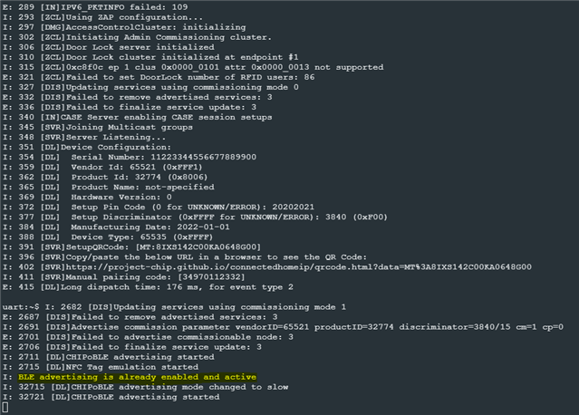

Hi, having some issues with the matter door lock sample for the nRF54L15DK on NCS 3.0.2. I'm getting strange failures on boot when running the default matter door lock sample that result in apple home commissioning failing to find the door lock.
Sample location: nrf/samples/matter/lock
Build command: west build -b nrf54l15dk/nrf54l15/cpuapp -d build_nrf54l15dk
It seems like theres a failure to init the door lock cluster with "RFID users: 86" even though i haven't touched anything by default and it seems like the source code should be initing this to 0. Afterwards it looks like theres failures to update advertised services which appears to prevent the apple home app from finding the devkit during commissioning with the QR code provided in the logs.

E: 325 [ZCL]Failed to set DoorLock number of RFID users: 86
I: 330 [DIS]Updating services using commissioning mode 0
E: 335 [DIS]Failed to remove advertised services: 3
E: 340 [DIS]Failed to finalize service update: 3

    It seems you would like to commission the Matter door lock sample to Apple Home over Wi-Fi. If so, it needs the nRF7002 wifi device to support. Since nRF54L15DK and nRF52840DK don't support the WiFi function, you should use nRF5340DK+nRF7002EK for Testing switching between Thread and Wi-Fi
    Amanda H.
  • Hi Amanda, I'm trying to commission the Matter door lock sample over Thread by connecting to an Apple homepod via the Home App which the nRF54L15 and nRF52840 should support.
  • I've tried resetting both via the button and via the cli command with the same result (timeout finding device in Apple Home). Are you sure there are no issues indicated in the boot up logs?
  • Did you press and hold Button 0 on the nRF54L15DK (Button 1 on the nRF52840DK) for over 6 seconds to trigger the factory reset of the device and begin Bluetooth LE advertising?
    The log would show like this:
  • Hi Amanda, I realized I wasn't getting the advertising started log on the default nRF54L15DK lock build for some reason and had to manually enter "matter ble adv start" to initiate advertising. Still having trouble commissioning but I may have an issue with my commissioning environment, currently looking into it:

  • What versions of iOS on iPhone and Apple Home are you using?
  • I'm using an iPhone 15 Pro and a Home Pod Mini both connected to the same wifi network. Closing this ticket, there were some issues with the state of our in-office thread network. I was able to pair to the homepod but there were a few hurdles and oddities on my end since there are a bunch of matter devkits on my desk:
    - Only one unique matter device discriminator (CONFIG_CHIP_DEVICE_DISCRIMINATOR) may exist on a network, otherwise trying to pair another devkit with the same default discriminator won't work
    - I had to turn bluetooth off and on again on my iPhone on every repeated pairing otherwise I would see the phone rapidly disconnect and reconnect without sending any messages
