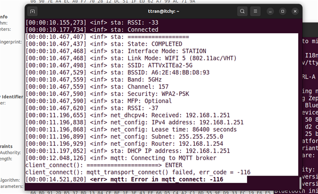

I have been trying to get MQTT+TLS to work on the nRF7002 DK and haven't been able to get the samples to connect to the MQTT Broker.
Is there a working MQTT TLS example?
I started off with the WiFi Station example and added the MQTT section following numerous setup.  None of which appears to work.  One thing I do notice during compilation is this warning appears:
CMake Warning at /home/ttran/ncs/v3.0.1/zephyr/CMakeLists.txt:1002 (message): No SOURCES given to Zephyr library: ..__nrf__subsys__net__lib__tls_credentials Excluding target from build.
I am not sure how to resolve this.  I have searched around for how to resolve this message but none of the resolve this.  I have tried numerous CONFIG_XXX in hopes that it will provide the "SOURCES" that the Zephyr library needs?
