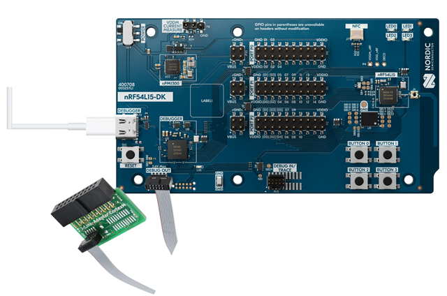

For simplicity's sake, here is my setup:
- nRF54L15DK
- Segger J-Link Debugger
- J-Link Adapter CortexM
- 10-pin 2x5 Socket-Socket 1.27mm IDC (SWD) Cable
(Pictured below)

So this leaves me with 2 possible solutions (?)
- Find a way to use the VCOM0 (The serial port that doesn't end with a 3)
or

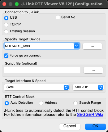

- Use  CONFIG_BT_DEBUG_MONITOR_RTT
But I can't seem to get the J-Link Probe to work with
Is there a different intended way to use RTT with these boards?
My end goal really is only to obtain the HCI Trace, so if there is a simpler way that does prevent the usage of the VCOM1, it could also be an ideal solution

    ''But I can't seem to get the J-Link Probe to work with''
    For the second one, you can check that you are using the latest version of the jlink RTT software and debugger is correctly connected to the PC.
    To capture and decode these traces, you should use the btmon tool from BlueZ with the --jlink option, specifying your device and serial number. For example:
    btmon --jlink nRF54L15_xxAA,<your_jlink_serial_number>
