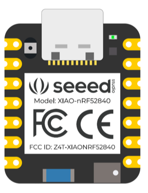

I’ve triple-checked hardware connections, including manual tests on SPI and GPIO pins, and tested with two nRF7002EB modules (surely both cannot have failed), so I believe the issue is a zephyr-specific configuration problem. I’m out of ideas and would appreciate any insights on what I’m missing.
One thing I was aware of is the QSPI port offering an optional flash chip on the Seeed studio platform, so I ensured I explicitly set that dt property as disabled.
Can anyone point me in the right direction as it's reached a point where i'm going around in circles and I do want to get this working on an NRF52840 to support an existing board... Below is my device tree overlay, the compiled zephyr.dts and the main.c

PINOUTS:
# Connection Table
| Colour | NRF52840 Pin | NRF52840 Pin Name | NRF7002EB Pin | NRF7002EB Pin Name | Function                                |
| ORANGE |    P1.13     |        D8         |       1       |        CLK         | QSPI Clock / SPI Clock                  |
| GREEN  |    P1.12     |        D7         |       2       |         CS         | QSPI slave select / SPI slave select    |
|  BLUE  |    P1.15     |        D10        |       3       |         D0         | QSPI DATA0 / SPI_MOSI                   |
| YELLOW |    P1.14     |        D9         |       4       |         D1         | QSPI DATA1 / SPI_MISO                   |
| WHITE  |    P0.02     |        D0         |       5       |         D2         | QSPI DATA2                              |
| PURPLE |    P0.03     |        D1         |       6       |         D3         | QSPI DATA3                              |
|   -    |      -       |         -         |       7       |        CT0         | SW1_CTRL0 (not supported on nRF7002 EB) |
|   -    |              |         -         |       8       |        ST1         | Coexistence interface priority signal   |
|  RED   |      -       |         -         |      10       |        VBAT        | Supply voltage (3v3)                    |
| BLACK  |      -       |         -         |      11       |        GND         | Ground                                  |
|  RED   |      -       |         -         |      12       |        VIO         | IO Supply voltage (1.8v)                |
| ORANGE |    P0.28     |        D2         |      13       |        ST0         | Coexistence interface status signal     |
| BROWN  |    P0.29     |        D3         |      14       |         EN         | Power enable signal                     |
| YELLOW |    P0.04     |        D4         |      15       |        REQ         | Coexistence interface request signal    |
| GREEN  |    P0.05     |        D5         |      16       |        GRT         | Coexistence interface grant signal      |
|  GREY  |    P1.11     |        D6         |      17       |        IRQ         | Host interrupt signal                   |
