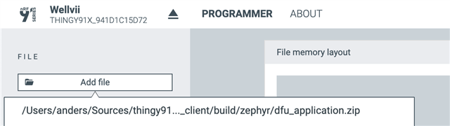

I am using nRF Connect for Desktop -> Programmer v4.6.2 to program the device
File: at_client/build/zephyr/dfu_application.zip

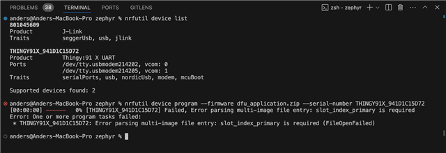

When programming I get the following failure:
Message: Failed, Error parsing multi-image file entry: slot_index_primary is required.
Same result if I try to use command line.
Full log:

2025-07-20T21:02:07.129Z ERROR Error: Failed with exit code 1.
One or more program tasks failed:
* THINGY91X_941D1C15D72: Error parsing multi-image file entry: slot_index_primary is required (FileOpenFailed)
2025-07-20T21:02:07.129Z ERROR Modem DFU failed with error: Error: Failed with exit code 1.

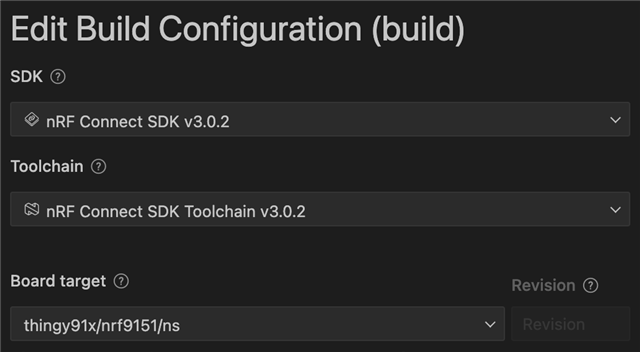

  • Deleted old at_client and started with at_client from nRF Connect SDK v3.0.2. Built successfully. Loaded on target successfully.
    Deleted build directory. Added mrf91-modem-uart-trace snippet to build configuration
    Got following build error (re-build here to shorten output):

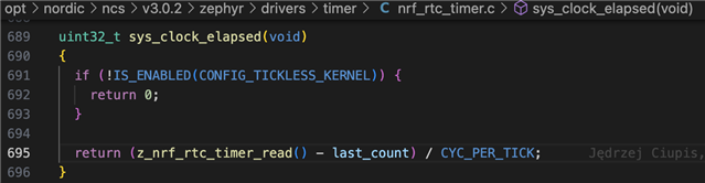

  • I do suspect this has something to do with configuration. The prototype is found in
    <zephyr/drivers/timer/system_timer.h> and I see the implementation in the drivers in zephyr/drivers/timer/*.c files.
    Namely nrf_rtc_timer.c and nrf_grtc_timer.c (if one of those is appropriate for the platform).
    Question is if timer driver is supported by the platform and what configs includes the timer implementation files in the build.
  • Since implementation is in nrf_rtc_timer I did the following
    rtc0 or rtc1 is not included in thingy91_nrf9151_ns.dts, so I added app.overlay with
    &rtc0 {
    status = "okay";
    And added
    CONFIG_NRF_RTC_TIMER=y
    To my prj.conf file.
    Still same error: undefined reference to `sys_clock_elapsed'
    So the question remains:
    How do I get nrf_rtc_timer.c included in my build. (If that's the implementation I need).
