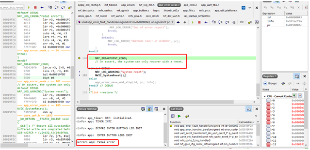

However, when I flash the same firmware to my custom nRF52832 module, the BLE functionality works but the app_timer (RTC-based) and uart communication functionality does not work.
After debugging, I noticed that the code gets stuck at a specific point repeatedly during execution, and it seems related to the RTC initialization or operation.
The custom module uses only one external 32 MHz crystal (for BLE), and does not have a 32.768 kHz LF crystal. I suspect the problem is due to the lack of the LF crystal, which is typically used for the RTC and app_timer.
after debugging i get my script everytime get stucked at debug data
<info> app_timer: RTC: initialized.
<info> app: Debug logging for UART over RTT started.
<info> app: Connected <info> app: Data len is set to 0xF4(244)
<info> app: p_evt->type: 2
<info> app: BLE_NUS_EVT_RX_DATA: 0
getting stucked after this and nothing work

  • You have CLOCK_ENABLED that needs to set to 1 and make sure all nrf_drv_clockxx files are included in the project. There is a bit of documentation for that here.

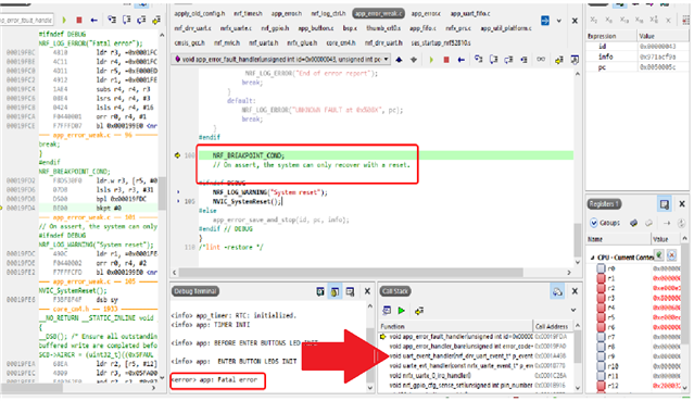

    But if you main problem is assert, then you need to know exactly where in uart_event_handler your program is asserting
    It looks like this is an manually inserted assert to tell the app that it is doing something wrong. When you reach to this point, click on the uart_event_handler in the function call stack and you will know which instruction caused the PC to take the assert handler path.
