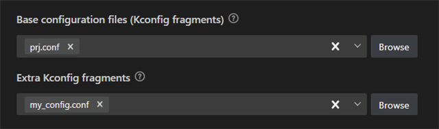

Using NCS 3.0.2 I have multiple build variants of my project, based on the same custom PCB but with different parts fitted, and different functionality. So I have create different build configs with custom dts files - this works OK.
I would like to add some of my own custom config entries, so I'm trying to use a Kconfig fragment, but whatever I try I get a "ignoring malformed text" error
Here's an example:
config FOO
  bool "foobar"
  default n
Cwarning: ignoring malformed line 'config FOO_BAR'
Cwarning: ignoring malformed line '  bool "foobar"'
Cwarning: ignoring malformed line '  default n'
Where am I going wrong...?

  • I wonder what you mean by wrong file type? Does it need to be a particular name and extension?
    What you seem to have done is made a config for the application; what I need to do is add extra fragments to different build configurations so each build has its own Kconfig add-on.
    I saved your config into a text file, then added it to a test build configuration as an Extra Kconfig fragment like so:
    Ah I see. Adding a new Kconfig is exactly what the snippet you shared did, so I thought that was the intention.
    If you want Kconfig fragment, you can just create a new .conf file with similar syntax to the familiar prj.conf, like this.
    Yes. Both file name and extension are significant to the build system. Please refer to both NCS and Zephyr application development guides:
    NCS: Application development
    Zephyr: Developing with Zephyr
