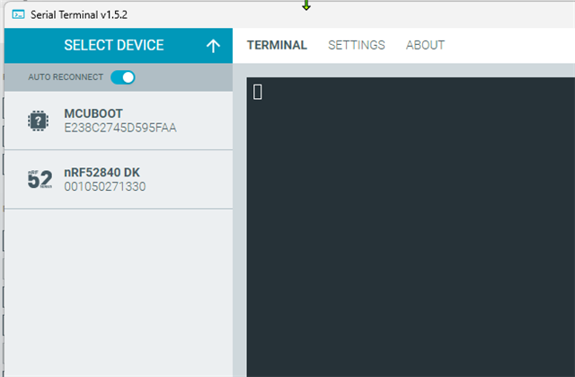

BUT, when I power cycle, something weird happens and I only see "MCUBOOT" in the serial monitor list of devices.
The update does not survive a power cycle.

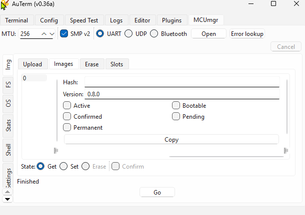

Strangely, when I use AuTerm to probe the image list, I get no image identified... (no hash, nor flags).

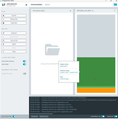

I do see the image in place using the nrf programmer
