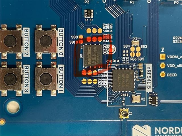

How to test flash of nRF54L15?
I'm interested in testing the flash of the nRF54L15. Are there any sample applications or existing projects that could help me get started?

    Kind Regards,
    Abhijith
  • Hi Abhijith,
    Thank you — I was able to successfully build and flash the sample. I just need to confirm one thing: does this sample operate on the flash labeled U9 on the nRF54L15-DK board, or is it targeting the internal flash within the chip? We're specifically interested in the U9-labeled external flash.
    PG
    The MX25R6435F module you mentioned is the external flash integrated on the nRF54L DK ,not the internal flash. The sample I referred to works with the internal flash of the nRF54L15.
    To work with the external flash, you’ll need to configure it first for the application/mcuboot (depending on your use case). You could start by looking at the JEDEC SPI NOR sample as a reference.
