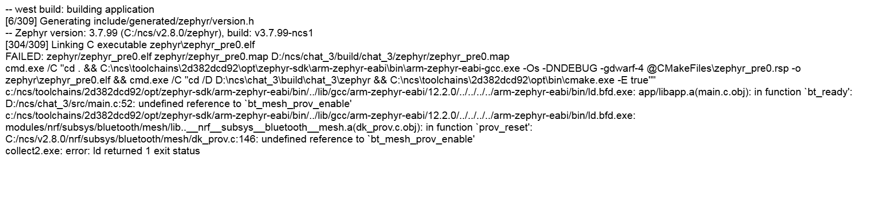

Can someone help me out for this problem, many thanks in advance !!!!!!!!!
Hello KHATRAN,
I just checked and there is no issue building the Bluetooth Mesh Sensor Server sample on NCS v2.8.0. There shouldn't be any .exe file reference in any source code file in the SDK, and there definitely isn't any reference to bt_mesh_collect2.exe in nrf/subsys/bluetooth/mesh/dk_prov.c.
It seems that your SDK is modified and not in a good way. I recommend reinstalling it.
Hieu
Hello KHATRAN,
