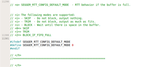

    I recommend you try to reproduce this while in a debug session (if you are using Keil, segger embedded studio, or similar) and pause the debugger when this happens to check where the program hangs. Also if using the RTT backend, ensure the SEGGER_RTT_CONFIG_DEFAULT_MODE setting is not set to 2=> BLOCK_IF_FIFO_FULL in your sdk_config header.

    I try again without debug session.In this test, I deliberately increased the log output volume so that it would display "Logs dropped".But this time the output look like this:
