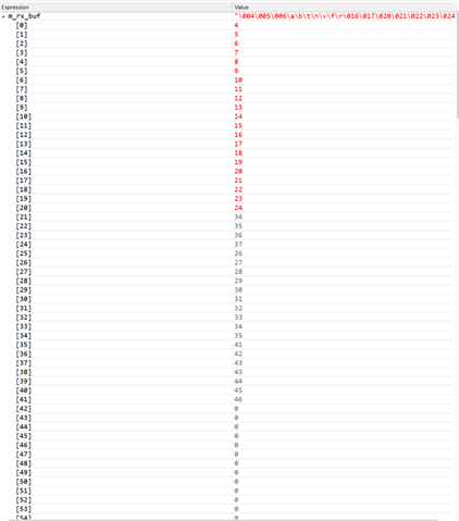

Firstly good day to anyone reading this query, hoping to find a solution for the issue here.
I am trying to create a BLE device using nrf 52382 which transmits Audio file data over BLE which it receives from another controller.
So I am using EasyDMA-SPI in nordic to receive 255 bytes and send the same data over ble to android APP, so that the transfer is fast, uninterrupted and seamless.
But I am facing an issue while receiving data over DMA, my rx buffer of SPI DMA is unable to receive all 255 bytes in continuation. After certain index number the data stops coming and then it again starts receiving left over data from index 0, and this behaviour can happen at any index value and it seems random. Some times starts over at index value 4 and sometimes it even goes upto value 42.
I am using spis example from nrf52 DK v16.
Here is the code. SPIS1_EASYDMA_MAXCNT_SIZE is set at 8

and below is the issue in the attached photos
here is first transfer received of 255 bytes
and below is the random change in index value.
looking forward to a solution from the community.
