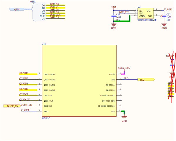

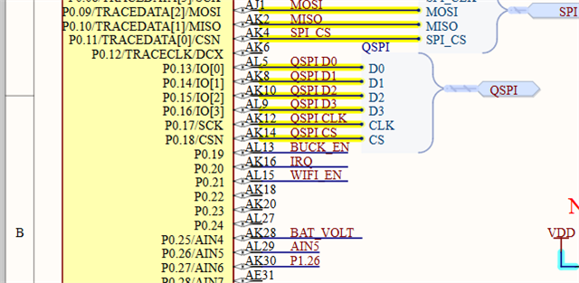

We are using a nrf7002 for wifi only alongside a nrf5340 host MCU on a custom board.
We are testing the wifi connection using the sample `nrf/samples/wifi/shell`, with the following configuration:

Communication with the wifi chip over QSPI works on boot, and we can do a wifi scan and see the output.
Getting wifi statistics works as well.
However, whenever a TX command is used (wifi connection, wifi scan -t active, etc), the wifi chip seems to freeze/halt.
Please see the attached log from a `wifi connect` attempt.

The five pins that are not connected to the nRF5340 are because we are not using the Bluetooth Radio. The VDDIO is 2.5V and Vbat Is fixed with an LDO to 3.3V.
Please see the attached schematics.

    Are you able to reproduce this on an nRF7002 DK or is it only reproducible on these custom boards? Let's try to narrow down whether it's a HW or SW issue first.
    Simon
  • Hello Simon,
    We figured out the source of the error. The output voltage for VBAT was very unstable under an oscillospoce with a PK-PK of 700mV around an RMS of 3.3V. Since the current draw was larger than expected the resulting voltage drop and oscillations would drop the VBAT voltage under 2.9V at some points during transmissions. We experienced a plain old brown out in this case.
    Thank you for you time, we have resolved the issue.
  • Glad to hear that Sebastian. Closing this case then!
