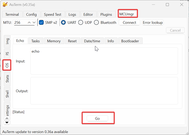

    It looks like this config options resolve the issue on boot. I don't see the crash, but UART does not work. Let me describe more about it. I use UART0 for logs and it works. Also, I use UART1 for MCUMGR and I want to use it with async API. When I enable options you recommended I don't see that this UART works. No any answer from it. I modified the test project and attached to this post. As I mentioned earlier, I use nRF52840DK board. Also, .config file is inside attached archive.
    Please, take a look.
    UART_issue_1.zip
  • May I ask you how you are testing this and what your setup looks like?
