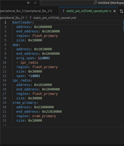

Using the following pm.yml file (same as for app core, except the flash base address is 0x1000000 for net core)
bootloader:
  address: 0x1000000

    To ensure your static partitioning file is correctly applied to the network core build, please try the following:
    1. If it doesn't already exist, create a new file named sysbuild.cmake in the root directory of your project.
    2. In the file, add the following lines to set the PM_STATIC_YML_FILE for the ipc_radio build:
    if(SB_CONFIG_PARTITION_MANAGER AND DEFINED  SB_CONFIG_SOC_SERIES_NRF53X)
      set(ipc_radio_PM_STATIC_YML_FILE ${CMAKE_CURRENT_LIST_DIR}/<insert name of your netcore partition file>.yml CACHE INTERNAL "")
    endif()

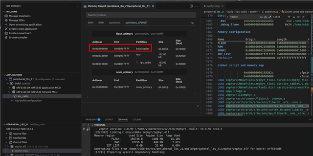

    EDIT: I tested with SDK v3.0.0 by placing a placeholder "bootloader" partition at address 0 and confirmed that it worked.
