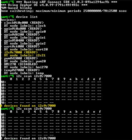

I2C devices are not getting detected in NRF54L15 Dev Kit.
I am unable to detect any i2c device when connected to the Nordic nRF54L15 DK kit. I have change the voltage from 1.8v to 3.3v and Tried and explore other pins in Port 0 and Port 1
I am using SDK 3.0.2 and toolchain version 3.0.2 in VS Code NRF Connect.
Below is Nnr54L overlay file.

I am using Shell to do i2c scan i2c@c7000 to identify the devices connected in Port 1 Pin 2 SCL and Pin 3 SDA
Proj.Conf
CONFIG_STDOUT_CONSOLE=y
CONFIG_PRINTK=y
CONFIG_PWM=y
CONFIG_SHELL=y
CONFIG_SENSOR=y
CONFIG_SENSOR_SHELL=y
CONFIG_I2C=y
CONFIG_I2C_SHELL=y
The device tree is showing SCL and SDA pins
Scanner output :
Not sure if I am missing any inputs. appreciate any support.
Setup Image : Connections are verified.
