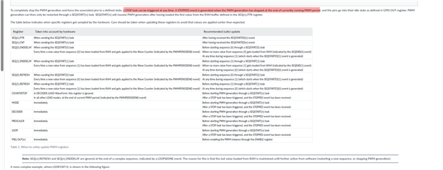

My first question is what are the options for stopping this once started? Can it be stopped after the current buffer (which could be either SEQ[0] or SEQ[1]) is complete? Can it be stopped after the current sample has been processed? How should it be stopped, is the assignment PWM.TASKS_STOP = 1 enough to stop it and when exactly does this stop it? The code I'm looking at waits for PWM.EVENTS_STOPPED to be non zero to indicate the stop has taken effect.
I see this in the docs.
In this case, an automated playback takes place, consisting of SEQ[0], delay 0, SEQ[1], delay 1, then again SEQ[0], etc. The user can choose to start a complex playback with SEQ[0] or SEQ[1] through sending the SEQSTART[0] or SEQSTART[1] task. The complex playback always ends with delay 1.
Does the sentence I have underlined imply it can only be stopped / will only stop once SEQ[1] is fully processed/complete?

    The PWM can be stopped at any time, also in the middle of a sequence. From the same PWM chapter you linked to:

  • I've been working my way through a few things. A brief bit of testing of PWM.ENABLE = 0 after the stop code seems to do the job but the answer to this mystery may be in the SDK library code. I see the implementation of nrfx_pwm_stop() includes a very relevant comment and additional hw register setting.
        // Deactivate shortcuts before triggering the STOP task, otherwise the PWM
        // could be immediately started again if the LOOPSDONE event occurred in
        // the same peripheral clock cycle as the STOP task was triggered.
        nrfy_pwm_shorts_set(p_instance->p_reg, 0);
    I had already tried setting SHORTS to 0 but I was doing it after the STOP setting. That improved things but wasn't perfect. I'll re-order them and do some more testing.
    The library code also does an ENABLE = 0 if waiting for completition is requested.

    The comments in the code suggest there's no way to do a reliable STOP after the current buffer has been processed when using LOOP and SHORTS. Is that true? Something like a PWM.EVENT_STOP_AFTER_CURRENT_BUFFER = 1 type thing?
    Not sure I understand fully, but I guess you can check out the PWM hardware chapter on what may be possible:
    https://docs.nordicsemi.com/bundle/ps_nrf52833/page/pwm.html
