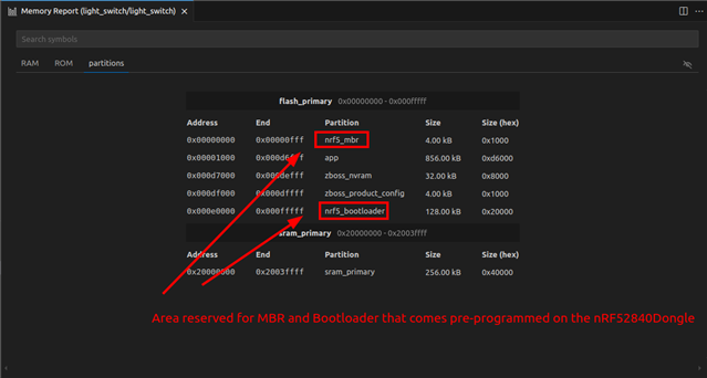

nrf52840 dongle: zigbee example light bulb on 2xx or 3xx sdk/toolkit not working (but nrf52840dk works..)
I've seen other threads about the issue:
https://devzone.nordicsemi.com/f/nordic-q-a/117267/light-bulb-sample-works-on-nrf52840dk-and-doesn-t-on-nrf52840-dongle
https://devzone.nordicsemi.com/f/nordic-q-a/85277/settings_subsys_init-causes-a-bus-fault-on-nrf52840-dongle
There seem to be an issue with the way nrf52840 dongle is partitioned. I need to create static partitions using pm_static_nrf52840dongle_nrf52840.yml, also there's a github example, but it looks like it requires older sdk 1.9.1 and segger studio... and I just struggle to make it work.
I have nrf52840dk and it just works out of the box...
can someone please help, all I need is a simple example to flash it, connect to zigbee and 1 led control working
