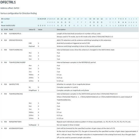

However, from the table provided by white paper https://docs.nordicsemi.com/bundle/nwp_036/page/WP/nwp_036/iq_sampling.html, it is said that
So, I was wondering what SW: 2, RR: 3, SS: 3 do mean.
for example, SW:2, does it mean that TSWITCHSPACING is 2us ?,
But, for RR:3, the table from white paper only indicates the option for TSAMPLESPACINGREF 1us
also for SS:2, the table only indicates TSWITCHSPACING is either 2 or 4us.
is there any documentation explains that? or do they mean something else?
