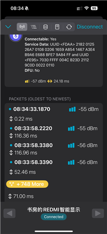

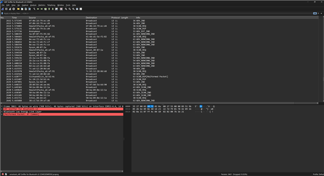

I want to know if I send a data from peripheral, how many time the central device could receive. Some people said that I could use the sniffer to caputure the interval between Sending packet and Receiving Packet. However, I cannot caputure the connection packet in my wireshark:
My question is:
1. How could I capture the connection packet using a sniffer?

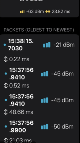

2. I noticed nRF Connect gives latency (23.82ms). Could this be the right number I wanted? What is the relationship between 23.82 ms and the other 0.22 0.52 48.66ms?
