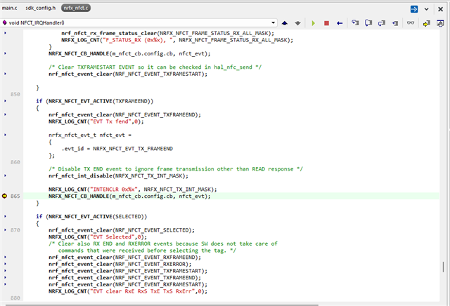

    Could you specify how it fails? Does it build successfully?
    regards
    Jared
  • I am sorry for the late answer.
    Yes, it build successfully.
    But there is something wrong in the message I guess, I don't know what is it.
    The message is "811000f542656e48656c6c6f20576f726c642111000105424e4f48616c6c6f2056657264656e2141100012542504c576974616a20c59a77696563696521
    �TenHello World!TNOHallo Verden!ATPLWitaj Świecie!"
    When I scan it with nRF NFC Toolbox it shows 'scanning failed'

    But it shows a message on the mobile ''Communication with the NFC tag was interrupted. scan result may be incompelete or inaccurate. Please hold the device closer to the tag"
    And it work well with the original record_launch_app version
    Can you build the project in debug mode, enable logging and see what the log output says when you get that message on the phone?

  • I updated the code to be
    static void nfc_callback(void *context,
    			 nfc_t4t_event_t event,
    			 const uint8_t *data,
    			 size_t data_length,
    			 uint32_t flags)
    	ARG_UNUSED(context);
    	ARG_UNUSED(data);
    	ARG_UNUSED(flags);
    	switch (event) {
    	case NFC_T4T_EVENT_FIELD_ON:
    		dk_set_led_on(NFC_FIELD_LED);
    		printf("data is read %s \r\n", data);
    		printf("data is read %d \r\n", data_length);
    	case NFC_T4T_EVENT_FIELD_OFF:
    		dk_set_leds(DK_NO_LEDS_MSK);
    	case NFC_T4T_EVENT_NDEF_READ:
    		dk_set_led_on(NFC_READ_LED);
    	case NFC_T4T_EVENT_NDEF_UPDATED:
    		if (data_length > 0) {
    			dk_set_led_on(NFC_WRITE_LED);
    			printf("NFC_T4T_EVENT_NDEF_UPDATED is written %s\r\n", data);
    			printf("NFC_T4T_EVENT_NDEF_UPDATED is written %d\r\n", data_length);
    	case NFC_T4T_EVENT_DATA_TRANSMITTED:
    		printf("NFC_T4T_EVENT_DATA_TRANSMITTED is read %s\r\n", data);

    Looking at the writeable sample, I see that the code enters this line during a NFC_T4T_EVENT_NDEF_READ event:
    Can you build your code in debug mode, and set a breakpoint there and see if the code enters this part in the nrfx_nrfct.c driver when you expose the tag to a field?
    regards
    Jared
