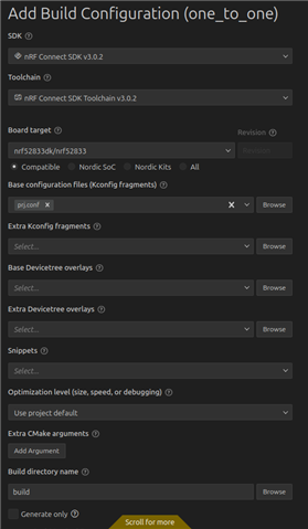

    3. When I try to build path/to/ncs/modules/hal/nordic/nrfx/samples/src/nrfx_gppi without any modification but just the build config:
    I get:
    CMake Error at CMakeLists.txt:11 (GET_DEVICE_CONFIG_FILES):
      GET_DEVICE_CONFIG_FILES Macro invoked with incorrect arguments for macro
      named: GET_DEVICE_CONFIG_FILES
    while
    cmake_minimum_required(VERSION 3.20.0)
    if(DEFINED CUSTOM_BOILERPLATE)
        include(${CUSTOM_BOILERPLATE})
        return()
    endif()
    set(COMMON_PATH ${CMAKE_CURRENT_LIST_DIR}/common)
    include(${COMMON_PATH}/common.cmake)
    GET_DEVICE_CONFIG_FILES(${BOARD} boards)
    project(one_to_one)
    target_sources(app PRIVATE main.c)
    target_include_directories(app PRIVATE common)
    If i fix the error by
    # GET_DEVICE_CONFIG_FILES(${BOARD} boards)
    I can build for nrf9160dk/nrf9160 but not for nrf9160dk/nrf9160/ns:
    /ncs/v3.0.2/modules/hal/nordic/nrfx/drivers/include/nrfx_gpiote.h:183:57: error: 'nrfx_gpiote_0_irq_handler' undeclared (first use in this function); did you mean 'nrfx_timer_0_irq_handler'?
    /ncs/v3.0.2/modules/hal/nordic/nrfx/drivers/include/nrfx_gpiote.h:76:33: error: 'NRFX_GPIOTE0_INST_IDX' undeclared (first use in this function); did you mean 'NRFX_TIMER0_INST_IDX'?
