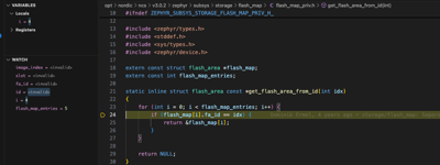

Error when adding mcuboot for a custom nrf5340 board in the get_flash_area_from_id and dynamic partitioning
I am using a custom board with a nrf5340 and vs code with sdk/toolchain version 3.0.2 and trying to get mcuboot working for FOTA. I have been stepping through mcuboot with my segger and have breakpoints in mcuboot/main.c
I am using dynamic partitioning as recommended.

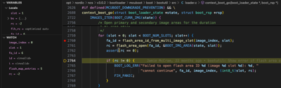

The error is happening on the second pass through this code within context_boot_go in loader.c:
        for (slot = 0; slot < BOOT_NUM_SLOTS; slot++) {
            fa_id = flash_area_id_from_multi_image_slot(image_index, slot);
            rc = flash_area_open(fa_id, &BOOT_IMG_AREA(state, slot));
            assert(rc == 0);
            if (rc != 0) {
                BOOT_LOG_ERR("Failed to open flash area ID %d (image %d slot %d): %d, "
                             "cannot continue", fa_id, image_index, (int8_t)slot, rc);
                FIH_PANIC;
  • slot = 1
  • flash_map_entries = 5
  • fa_id = 6
which calls:
int flash_area_open(uint8_t id, const struct flash_area **fap)
	const struct flash_area *area;
	if (flash_map == NULL) {
		return -EACCES;
	area = get_flash_area_from_id(id);
	if (area == NULL) {
		return -ENOENT;
	if (!device_is_ready(area->fa_dev)) {
		return -ENODEV;
	*fap = area;
	return 0;
  • id = 6
which calls flash_map_priv.h:
static inline struct flash_area const *get_flash_area_from_id(int idx)
	for (int i = 0; i < flash_map_entries; i++) {
		if (flash_map[i].fa_id == idx) {
			return &flash_map[i];
	return NULL;
  • i=4
  • flash_map[i].fa_id = 5
This call returns a -2:
  • slot = 1
and finally dies on this call in nrf53_cpunet_mgmt.c
static void onoff_stop(struct onoff_manager *mgr, onoff_notify_fn notify)
	nrf_reset_network_force_off(NRF_RESET, true);
	notify(mgr, 0);

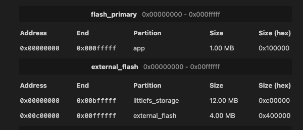

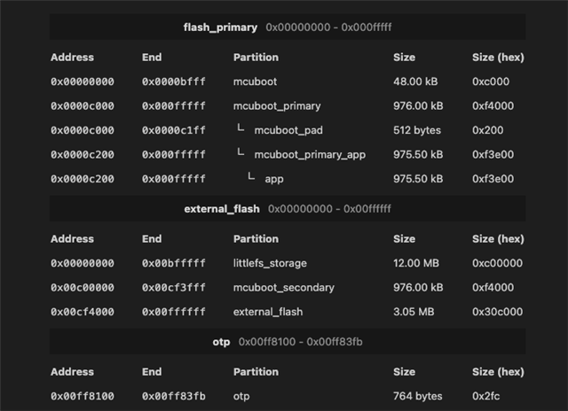

Here is the flash:
When I have SB_CONFIG_BOOTLOADER_MCUBOOT=n it runs
I have read Simultaneous updates for both cores of the nRF5340, but get errors when I get to:

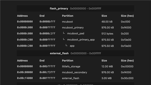

and my partitions.yml look like this:
app:
  address: 0xc200
  end_address: 0x100000
  region: flash_primary
external_flash:
  address: 0xcf4000
  end_address: 0x1000000
  region: external_flash
littlefs_storage:
  address: 0x0
  device: DT_CHOSEN(nordic_pm_ext_flash)
  end_address: 0xc00000
  placement:
    before:
    - tfm_storage
    - end
mcuboot:
  address: 0x0
  end_address: 0xc000
  placement:
    align:
      end: 0x1000
    before:
    - mcuboot_primary
mcuboot_pad:
  address: 0xc000
  end_address: 0xc200
  placement:
    before:
    - mcuboot_primary_app
mcuboot_primary:
  address: 0xc000
  orig_span: &id001
  - mcuboot_pad
  - app
  span: *id001
mcuboot_primary_app:
  address: 0xc200
  orig_span: &id002
  - app
  span: *id002
mcuboot_secondary:
  address: 0xc00000
  end_address: 0xcf4000
  placement:
    align:
      start: 0x4
  share_size:
  - mcuboot_primary
otp:
  address: 0xff8100
  end_address: 0xff83fc
  region: otp
rpmsg_nrf53_sram:
  address: 0x20070000
  end_address: 0x20080000
  placement:
    before:
    - end
  region: sram_primary
sram_primary:
  address: 0x20000000
  end_address: 0x20070000
    I recommend you follow the same approach as here (which you write you had loosly followed) more or less too the point. This should be valid also for any custom board provdied you have the external flash correctly configured. If that is the problem, can you back-track a bit and make sure you have yor SPI flash configured and working on your custom board with your custom baord files withotu DFU? (see this thread for that)
  • I do have the custom board working with external flash when SB_CONFIG_BOOTLOADER_MCUBOOT=n:

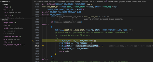

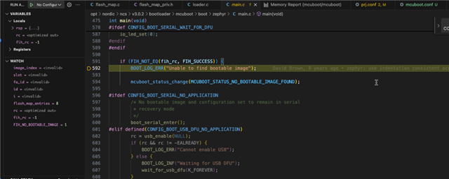

    Which image do you get this error for (typically your application or MCUboot)? Most likely something is not enabled in Kconfig shat should be. You can check in devicetree_generated.h in the build folder to see what __device_dts_ord_137 represents. See here and here for details on this.
  • I'm not sure what gets the error. Does MCUBoot build first?
    I think I am struggling across the boards with dynamic partitioning and mcuboot. The other project which I first referenced will build but is running into a non-existant flash id it needs, I think.
    Starting over and trying to follow the sample as much as possible, which I did, still deviates in a few areas, notably spi, the external storage being used, and vregh difference. Nonetheless I can get everything working (flash particularly) and building until I add mcuboot. I bet the 137 is related to the flash in some way.
    As in the Simultaneous updates for both cores of the nRF5340, I have:
    The original project above had some more complex structures (boards directory under ipc_radio and mcuboot directories with board specific overlay and conf).
    I still get the same error.
    /opt/nordic/ncs/toolchains/ef4fc6722e/opt/zephyr-sdk/arm-zephyr-eabi/bin/../lib/gcc/arm-zephyr-eabi/12.2.0/../../../../arm-zephyr-eabi/bin/ld.bfd: zephyr/drivers/flash/libdrivers__flash.a(spi_nor.c.obj):(.rodata.spi_nor_0_config+0x0): undefined reference to `__device_dts_ord_137'
    I do think when I get this built I will have the same get_flash_area_from_id error.

    And the error:
    Partitions defined by dynamic partitioning:
    I got the 2nd project to build by adding this in the mcuboot.conf:

    And the error:

  • Ok. I will give it a shot. We are essentially back to the first post I had. I think it's partitioning, since the error happens in get_flash_area_from_id, but I'm not managing the partitioning (except for specifying the littlefs size) because I'm using dynamic partitioning (as recommened by one of your engineers who I trust).
  • I read this post MCUboot warnings + app errors when using external flash which said:
    I think I "fixed" external flash set up by adding
    CONFIG_PM_OVERRIDE_EXTERNAL_DRIVER_CHECK=y
    (I added it in both prj.conf and in bootloader overlay config)
    I did have it in the prj.conf but needed to add it to the mcuboot.conf. This got me through the get_flash_area_from_id error, but I ran into an "Unable to find bootable image" error:
    which seems to happen in the boot_validate_slot call:
