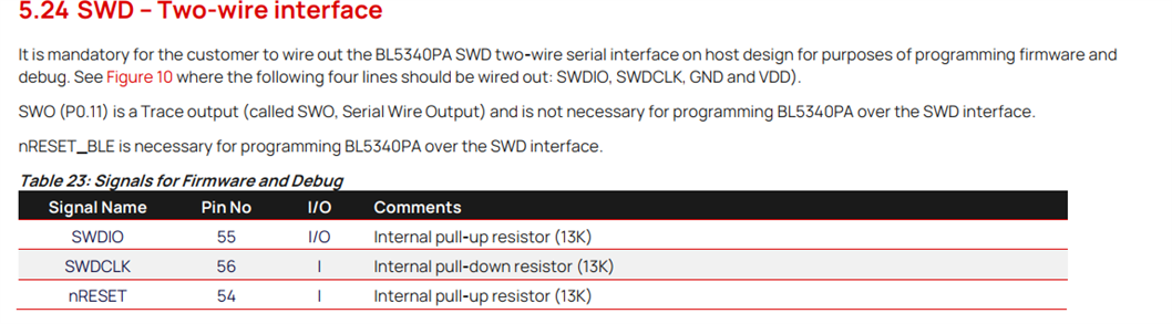

I have make a PCB with a BLE5340PA module from Ezurio using the nordic 5340 soc, i want to programm the soc but it seem that there is no boot on the module.
Fortunately i have all the pins of the module available on my board, i have i seen on BL5340PA data sheet that i can the pins :
to install a firmware but i don't know how to install a firmware and what tools to use (in the hardware part and software part), think you for your help !
