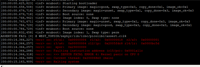

I’m currently setting up multi-image DFU on the nRF5340 using external flash.
By following the official documentation and samples, I managed to get it working correctly for the app core. However, just before the swap starts for the net core, I hit an assert after the call to the boot_read_image_size function in the boot_swap_image function within the loader.c file of MCUboot.
After adding some logs, I noticed that MCUboot either fails to read the mcuboot_primary_1 partition or the partition is completely empty.

  • Thank you for your response, that’s exactly what I had understood.
    But if I understand correctly, the DFU from the main application writes the new image to the external flash, and then after a reset, MCUBoot checks the flags in the image located in the external flash and, if necessary, performs the swap. It’s during this last step that my error occurs—more precisely, when MCUBoot tries to read information from the mcuboot_primary_1 partition (in the simulated flash in RAM).
    Here are the logs after reboot (before the swap performed by MCUBoot)
    It happens after the call to the boot_read_image_size(...) function in loader.c, inside boot_swap_image(...).

    Do you have any idea why, when MCUBoot tries to read primary_1, it only reads 0xFF values, which correspond to erase values if I understood correctly?

    I suspect something is wrong with the partitioning somehow. What will happen if you build without a pm_static.yml?
    I notice that at least the device value of mcuboot_primary_1 is incorrect. It should be nordic_ram_flash_controller.
    If the build without pm_static.yml can work correctly, I recommend copying the partitions.yml file under the build directory out and use that as the base for your new pm_static.yml.
