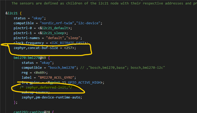

I am having issues getting the BMI270 sample working on an NRF54l15-DK, using nRF Connect SDK v3.0.2 and toolchain 3.0.2. After successfully building and flashing the program to nRF54L15DK, I got the error "Device BMI270 is not ready." How can I solve this problem?
I have installed I2C_SHELL and am able to see and access the device using the i2c Shell prompt. unable to access or configure this using devicetree. device list is showing as disabled. explored the option of status= "okay"; not solving the problem.
Need help.

&i2c21 {
    status = "okay";
    compatible = "nordic,nrf-twim","i2c-device";
    pinctrl-0 = <&i2c21_default>;
    pinctrl-1 = <&i2c21_sleep>;
    pinctrl-names = "default","sleep";
    clock-frequency = <I2C_BITRATE_STANDARD>;
    bmi270:bmi270@69 {
        status = "okay";
        compatible = "bosch,bmi270"; // ,"bosch,bmi270,base";
		reg = <0x69>;
		label = "BMI270_ACEL_GYRO";
        irq-gpios = <&gpio1 15 GPIO_ACTIVE_HIGH>;
        zephyr,deferred-init;
        wakeup-source;
        zephyr,pm-device-runtime-auto;

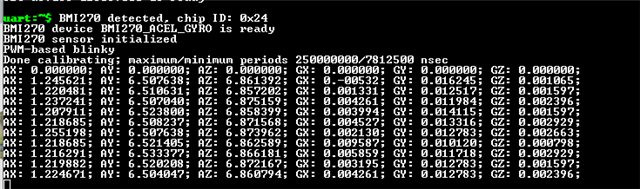

output :
The i2c scanner shows the device, and I am able to access it in the shell prompt and read the device.
Any help is greatly appreciated!
