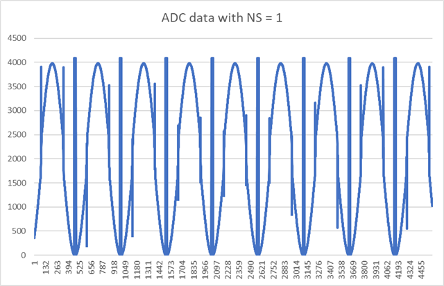

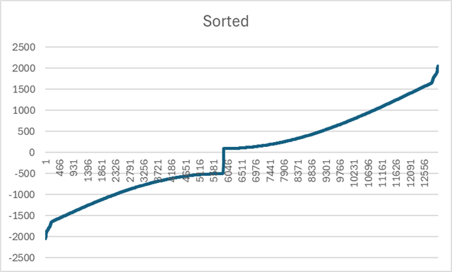

Here is an example of the output waveform plotted in Excel:
To eliminate data conversion issues, I also tried printing the raw signed values directly, and the spikes were already present before conversion.
Here’s what I’ve verified so far:
  • Without noise shaping, the waveform is clean and matches the input.
  • With noise shaping, the overall shape is correct, but spikes appear.
  • Spikes occur even when the input is a low-noise sine wave (from a function generator).

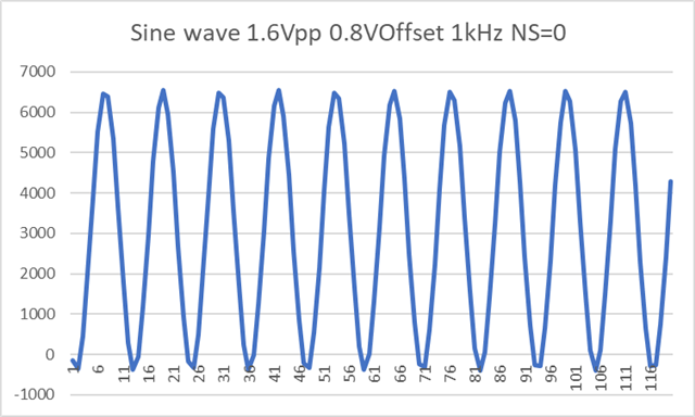

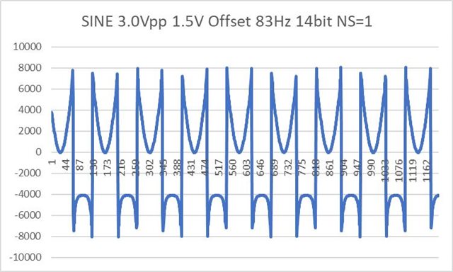

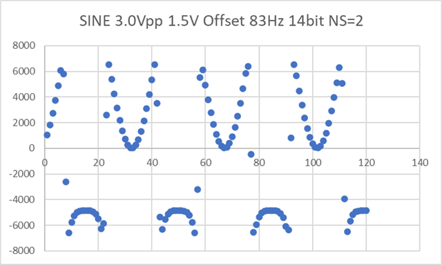

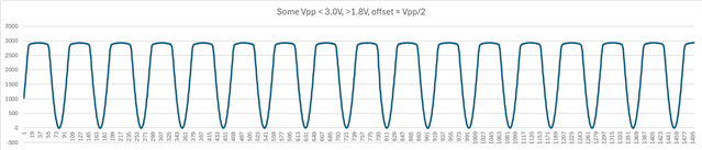

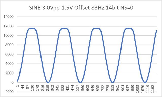

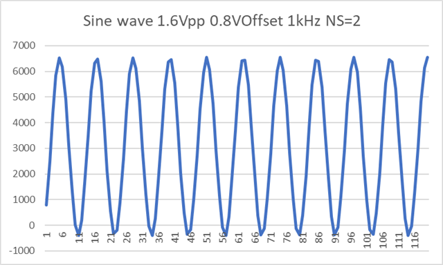

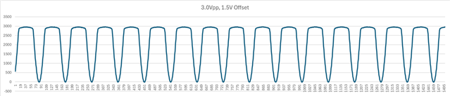

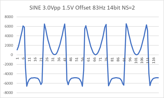

  • Hi Kyle,

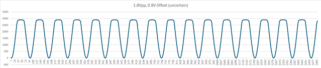

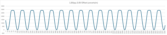

    In setting up the measurement today, I was reminded of an issue: the nRF54L15 DK VDD is 1.8V by default.
    Have you changed this when you measured?
    The issue is that the maximum voltage the SAADC can measure is VDD, and the absolute maximum rating of the pin would be VDD + 0.3V.
    Therefore, we can expect voltage above 1.8V to be measured incorrectly.

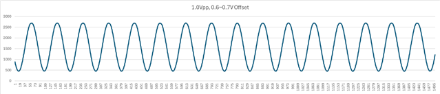

    Here are the results of the few tests I run today.
    There was no strange spike like you had at first.
    There was also no weird graphs like the ones you last sent.
    There are only the clipped off peaks that is expected.
    I was a little careless with note taking, so I lost track of the 2nd and 3rd result and am not sure what exactly the input was. However, consider they have the same characteristics of interest as the other results, I hope that is not a big problem.
    For now, I would say, if you want to measure the signal correctly, reconfigure the nRF54L15 DK to 3.6V supply, which is the highest recommended operating voltage.

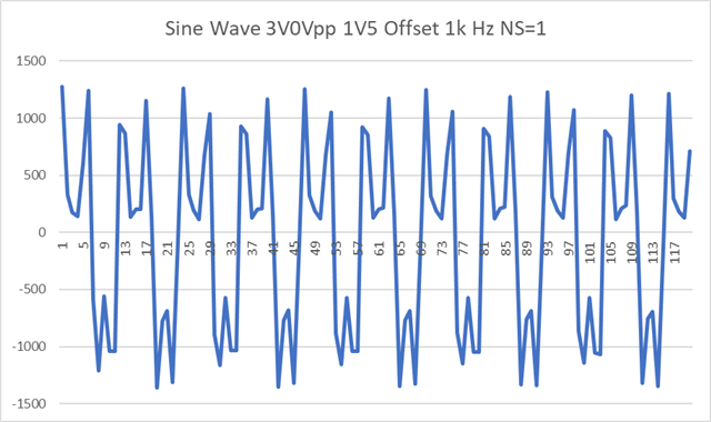

    Then you can reattempt with the 3.0Vpp, 1.5V offset signal.

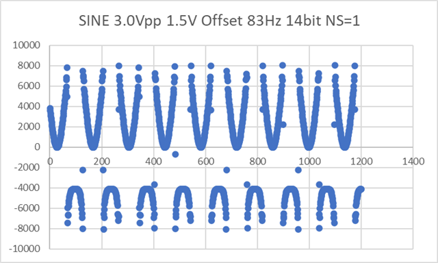

    Please also make sure to enable oversampling and 12-bit or higher accuracy, as mentioned in the datasheet.

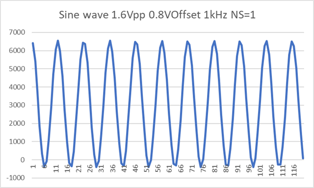

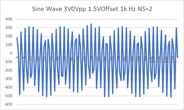

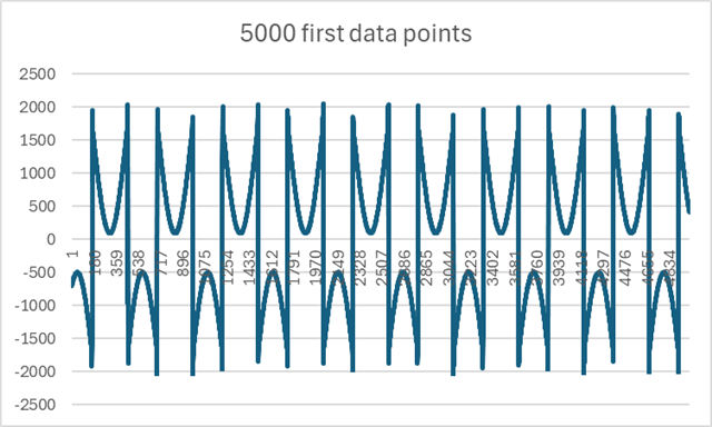

    As for the graphs you last sent, I initially thought it would be aliasing. That's why I asked for your input and sampling frequency.
    After I reproduce the setup today, I am now fairly certain that is the case.
    I actually was assigned to something non-DevZone from yesterday and will be away for a few weeks. Another engineer will continue to support you, so please feel free to reply.
    I will see if I can find time to reproduce my result some day, because they don't make total sense. 1.6Vpp shouldn't have been clipped off. I didn't notice that when I was just gathering data.
