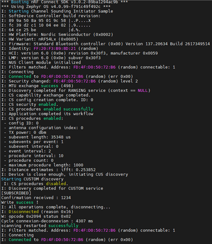

  • CS2_prog.zip
    Hello Edvin,
    So I implemented your solution and it works for the first loop.
    But, when the initiator is scanning for the second time, it's blocking here :
    I've tried a lot of things but I can't get it to work. I have linked my new program in the attached documents.
    It's working well if I reboot my device instead of scanning again in the disconnected_cb but I want to be able to not use the reboot since it consumes a lot.
    If you have any suggestion on how to solve my problem, it would be very helpful !
